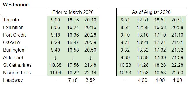

Some interesting changes in the new Niagara weekend schedules:
Departures are now following a clockface 4-hour headway. This allows the westbound service to be increased from 3 trains to 4 at minimal cost. The downside is that since both trainsets are based in Toronto, the first departure from Niagara Falls is now much later.
Trains now have an additional stop at Aldershot. Maybe this is a way to theoretically provide service from Hamilton to Niagara? It doesn't really help travel from Hamilton to Toronto, since there's plenty of parking available at Burlington on weekends and the Niagara Falls trains don't have associated GO bus connections to Hamilton. I would hope that once the new thru platform is built at West Harbour it would simply replace this stop rather than adding to it.
The train consists will apparently have 3 standard coaches and 3 bicycle coaches, compared to the usual consist of 5 standard coaches and 3 bicycle coaches. Personally I'm surprised there are still 3 bicycle coaches since the total number of bikes should be a fair bit lower than usual, and the bikes themselves don't need to practice social distancing.
Travel times remained the same, or even improved. I would have expected the travel time to increase west of Burlington due to the additional stop in Aldershot, and decrease east of Burlington due to the reduced conflict traffic on the line at the moment, and faster acceleration of the 6-car sets compared to the usual 8-car sets. But in fact it's the opposite:
I have no idea why the travel times are decreasing on the Niagara end of the line - even between Burlington and St. Catharines where a new stop was added - while they are increasing on the Toronto end of the line.

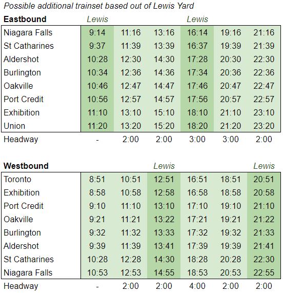

The easiest way to provide an earlier departure from Niagara Falls would be to use one of the trains based in Lewis Yard near Grimsby. The downside is that these are (normally) 10+ cars and lack bicycle coaches. This means that they would be a bit slower than the usual 8-car Niagara trains, and the schedule would probably need to note the limited bike-carrying capacity of those trips.
