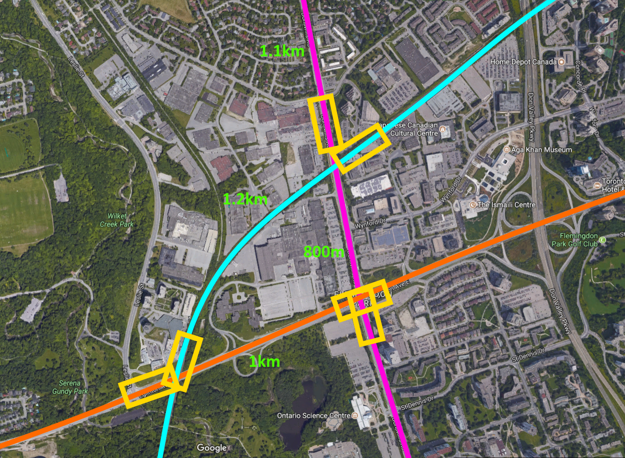

When I did my fantasy track map for the west half of the Midtown line, I showed the flyover/under being around the Humber River, but the west end of Lambton Yard is an even better location, with lots of underutilized wasteland:

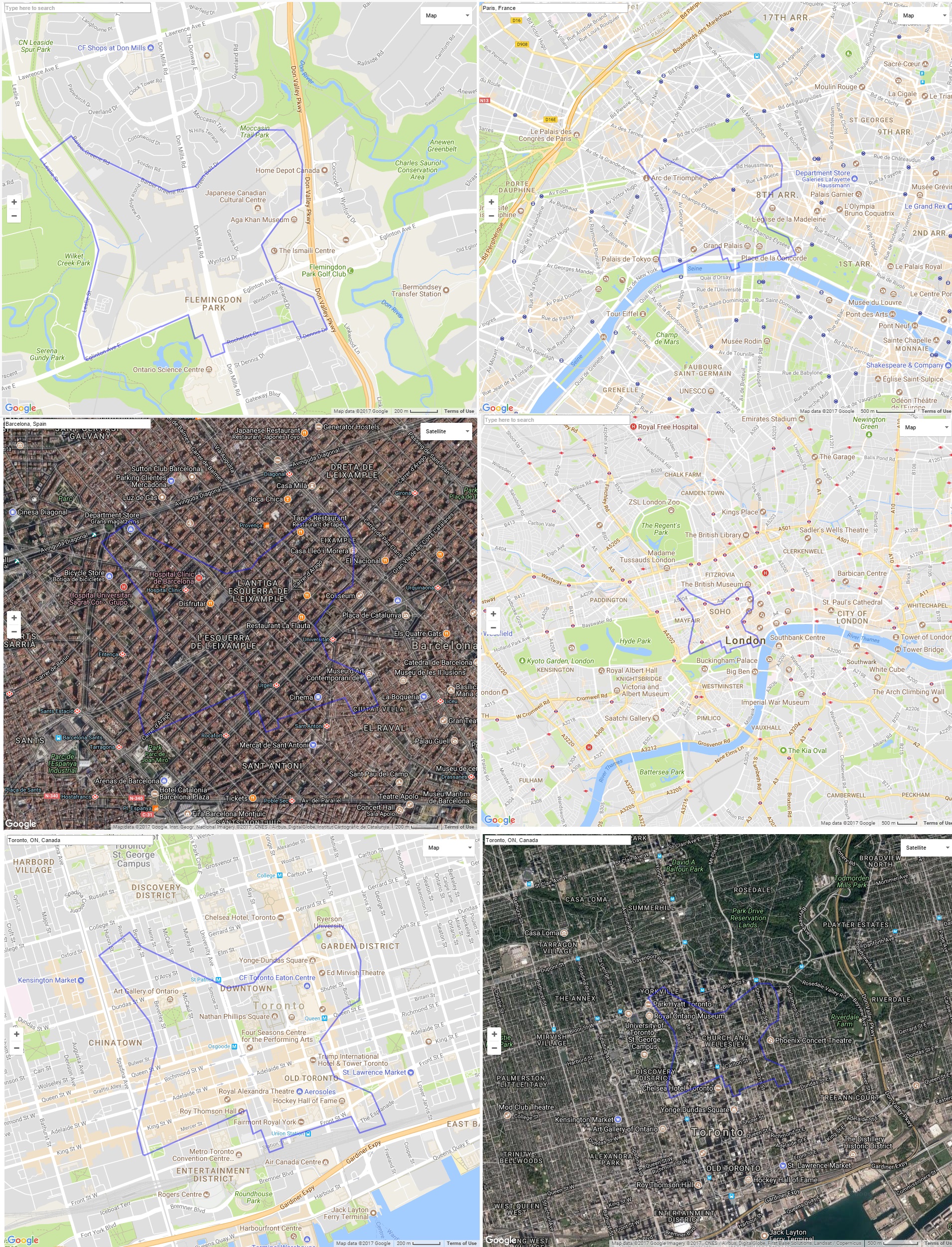

In a transit plan like that, we really should be thinking of how to build optimal levels of urban employment and population densities. This is not a tiny piece of land we are looking at here. Consider:
If there is anywhere in the city to consider creating a regional sub-centre from scratch, it would be at Eglinton and Don Mills. Especially if the Midtown Corridor is activated, and the Relief Line North is built (thus connecting here with the Unilever site and Downtown).
Maybe we do not need two stops at both Leslie and Barber Greene. I think if someone is heading to Yonge on Eglinton, a one-stop transfer from Barber Greene to Don Mills while not optimal, is not a deal-breaker.
