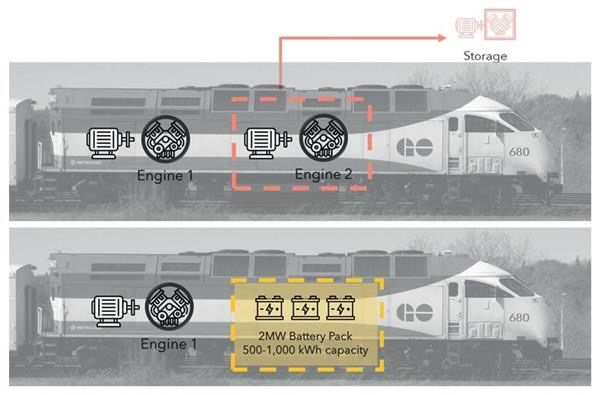

Colour me a bit confused because while we have 275 pages of possible battery use. MX has semi-publicly confirmed plans for a hybrid loco conversion. With a public tender out too since last December
Why are we acting as if Metrolinx is completely against hybrid electric?
This might go back to that theory that Mx has written off any change of Union and having the massive gap of the entire train shed? Which still blows my mind.

There are, broadly, two different scenarios where Metrolinx/GO might need hybrid locomotives:
  1. To extend beyond a core network which will eventually be electrified. This would only justify the conversion of part of the existing GO fleet (i.e., for those trains operating beyond the electrified core network).
  2. To bridge an electrification gap at Union Station. This would justify a full conversion of the existing GO fleet (as all trains operate through Union Station).
I suspect that the number of locomotives to be converted would give us a hint of which of these two scenarios might have motivated this RFP…
We aren't.... but just as ML wrote off one loco (647) a great many years ago in order to secure a prototype Tier IV design...and ten spent several years waiting for, and then testing a prototype before ordering any... this RFP is likely seeking a prototype that might eventually yield a production model.... and that production design is as yet unproven.
So it would be wrong to say that ML has made a decision.... it's good that they are testing the waters, but this may be exploratory rather than definitive.
Remember, too, that ML floated a RFP for a hydrogen locomotive.....in 2017. And we see how that turned out.

This concept design makes no logical sense imo. Why do they keep insisting on reinventing the wheel when Dual-Power locomotives already exist that can meet the needs for all lines and Union Station? Both Siemens and Alstom already make models for the North American passenger rail system that would meet the needs of GO both pre and post-electrification. Especially since long-term plans include running more frequent but shorter trains anyways.
It might make no sense in a lot of other settings, but it might well make sense here - considering that this is a testbed and not a decision to replace the entire fleet.
It makes sense thanks to having lines that need to coexist with freight landlords who are opposed to wires and also likely skeptical about the prospect of all-battery trains blocking their lines when the battery fails.
And it makes sense as an experiment with a fleet that might not be totally at end of life - those newer offerings come with their own power sources and parts aupply and learning curve. A hybrid that sticks with the known and maintainable diesel and control systems is less to swallow.
Plus I would challenge your claim that new models are actually out there for the taking… can you cite a single property where they are out there in production service ? Sure vendors will offer them, but ML would be unwise to go out on a limb as the first to bite.
A single test bed relying on what ML knows best makes a lot more sense for now.

Both exo and NJ Transit use the Bombardier/Alstom ALP-45DP which is remains in production as NJ Transit (designated as ALP-45A) continues to order more of them and has ordered 12 more of them this year.
From the Siemens side, 2 models exist within the Charger family and are in production:
  1. ALC-42E for Amtrak services that utilize the Northeast Corridor for portions of their journey or enter New York Penn station via the Empire Connection. This model uses a full size ALC-42 diesel locomotive semi-permanently coupled to an auxillary power car configured for either Battery-Electric operation for Empire Connection services (ie. Maple Leaf, Empire Service, Adirondack, Ethan Allen Express, Lakeshore Limited, etc) or Pantograph operation on the Northeast Corridor.
  2. SC-42DM for Metro-North, CTDOT. LIRR, NYSDOT which have been ordered in two different configurations:
    - Diesel and DC Third Rail for Grand Central, Penn Station via Empire Connection services
    - Battery and AC Pantograph for Penn Station via the Northeast Corridor.
The ALP-42E is not applicable as it requires a special passenger car to install the pantograph, transformer, and additional traction motors.
The other two models however are both good examples of dual-mode locos built for the North American operating environment.
