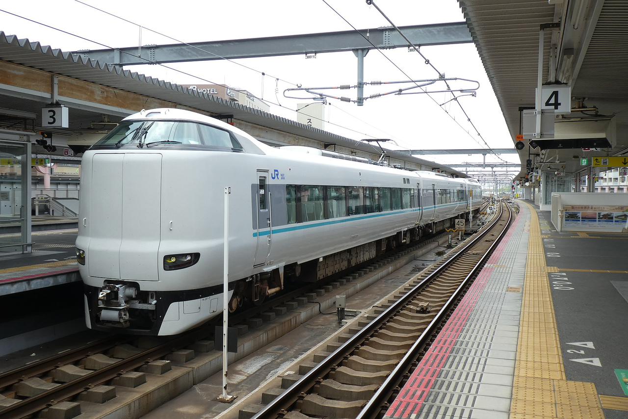

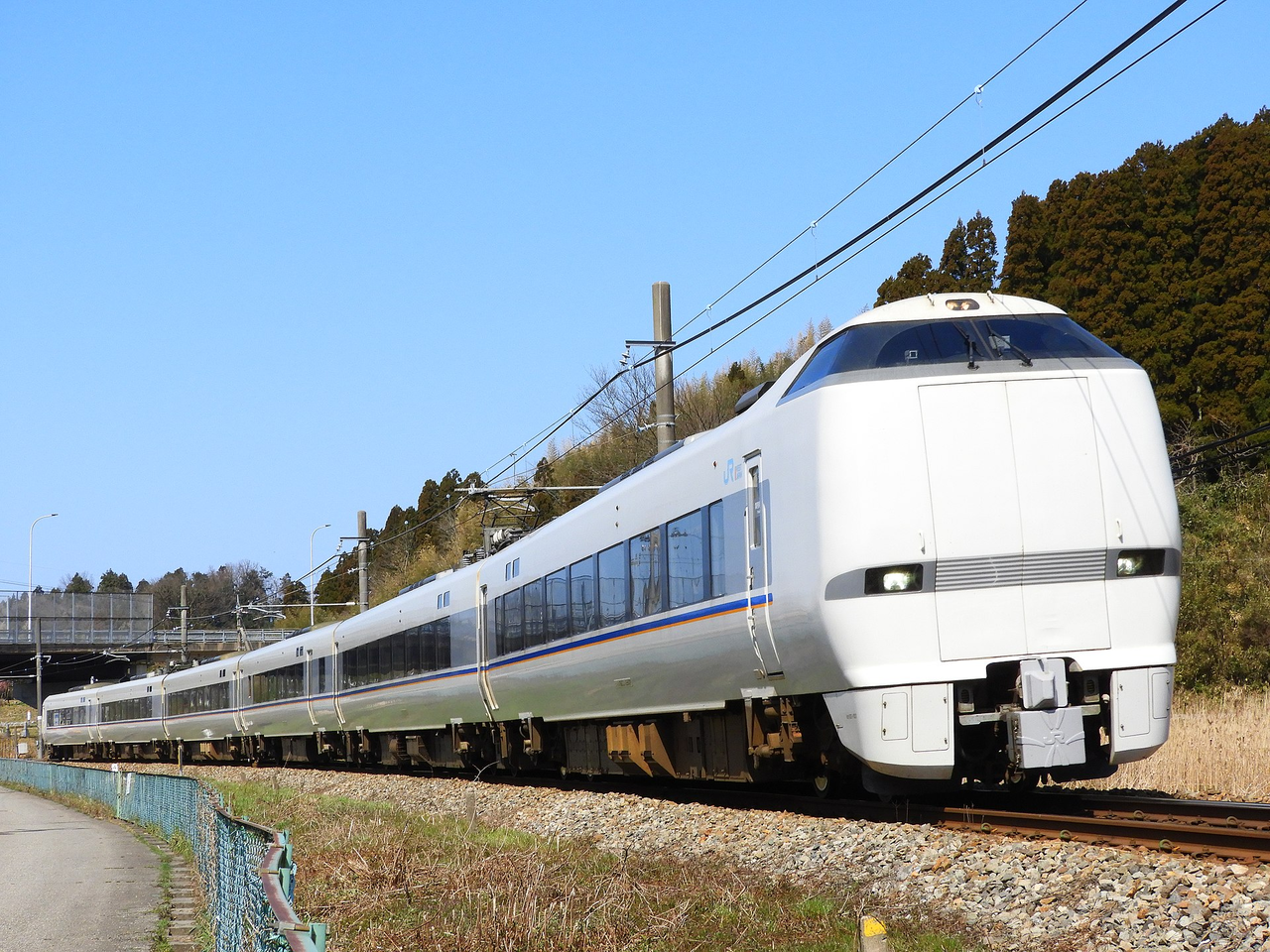

When I first saw it, it reminded me of the UAC Turbo Train and odd looking in Amsterdam.
more like the JR 287 and 683 Series. it looks almost exactly alike
