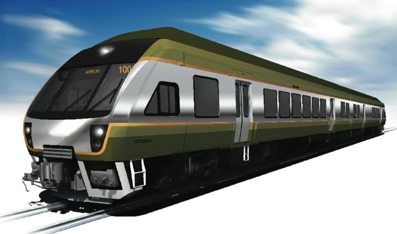

There will be EMUs almost right off the bat... the Nippon Sharyos have electric motors and were designed for easy conversion.
And it's been said that they aren't going to be converted because it's too expensive to do it and it would be cheaper to buy new ones at this point instead.
The Nippon Sharyos are diesel-hydraulic. They aren't even diesel-electric like most other diesel trains. I know they claimed that they could be easily converted to EMUs since that's what Metrolinx asked for, but I find it hard to believe. An easy-to-convert DMU would be like the Stadler FLIRT DMU, which is literally an EMU with a generator car.
The MR90 fleet just got prematurely retired and is sitting in storage. Maybe we can nab them up for cheap
The reason they wouldn't buy those is the same as the reason they wouldn't convert the Nippon Sharyos. Their floor height is completely wrong for Metrolinx's planned 610mm platforms. I think the best bet for the MR90s would be the CT Rail South Shore Line, since my understanding is that they didn't order enough Kawasaki M8 EMUs to fully convert the line to electric operations.
On the lines with only partial electrification (ie Kitchener) does this mean they'll be running diesel trains in between the electric trains for the longer routes? Would this affect the speed of the electric trains, or the frequency, or both?
Yes they will be running diesel trains between the electric trains.
No this will not negatively impact speed or frequency of the electric trains, because those diesels will almost certainly be making limited stops through the shared segment. It's actually the speed and frequency of (local) electric trains which will be limiting the speed of the (express) diesel trains.
Nitpick: they're not diesel-hydraulic. They aren't even diesel-hydrostatic, which is the term you were actually looking for.
They use a 6-speed transmission not unlike that used in a tractor-trailer. They are considered diesel-mechanical.
Is Wikipedia incorrect? Does the Nippon Sharyo DMU have a physical clutch (not a torque converter)?
https://en.m.wikipedia.org/wiki/Nippon_Sharyo_DMU
The Nippon Sharyos do NOT have electric motors. Believe it or not they are technically big Rail Buses. They literally have the diesel motor connected to the wheels by a 6 speed automatic transmission.
The plan was to swap the diesel engines out for an electric motor, but not only was it deemed too expensive versus just getting new trains, Nippon Sharyo has left the North American market and is no longer willing to do it. (You could always hire someone else to do it but i'd imagine it would not be the best idea considering it was already deemed too expensive)
The Toronto Nippons dont have hydraulic transmission. The SMART ones in California do. For some reason Metrolinx opted for the mechanical gearbox version.
Powertrain: Cummins QSK19-R, Tier 4 compliant, 6 speed automatic transmission
Yes, Wikipedia is incorrect.
The most common transmission used with the QSK-19R is a Voith T312bre hydrostatic transmission. This is used in quite literally thousands of railcars around the planet.
For whatever reason, someone spec'd the UPX equipment with a ZF 6AP2500R, which is a 6-speed automatic transmission. This isn't an uncommon transmission, but I can't find any other applications where it's been mated to the same Cummins engine.
