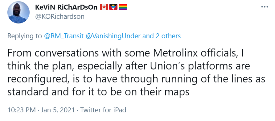

Another thing GO/Metrolinx should do is that they should have through-running of the existing GO lines shown on official maps. That way people won't have to see Union as the end-point of every GO line. They already through-run both Lakeshore Lines and to a lesser extent Stouffville and Kitchener. Not sure if they currently or used to through-run Milton and Richmond Hill.
Someone please correct me if im wrong, but This seems like actual news here.
People have proposed this before including TRBOT but this is the most definitive answer right now from metrolinx on "through-running" of the lines
The 2020 GO Expansion EA update (linked in the GO construction projects thread) shows clear frequencies for each of the 5 electrified lines will be (both peak and off-peak) starting at page 11.
No two lines have identical schedules. Some trains could run through (like the Stouffville and Kitchener 10 minute frequency portion) and LakeShore East/West 15 minute frequency portion, but many trains would still not be through service at union.
Once the new signalling system at Union Station is completed and operational, through-running of the lines will be a far greater hindrance to service reliability than many other factors that currently affect the lines - especially at peak times. The only lines that will continue to operate through the station at most times will be the Lakeshore Lines.
I thought through-running reduced dwell times and reduced operational complexity. It seems my understanding was wrong. Why would it hinder service reliability?
