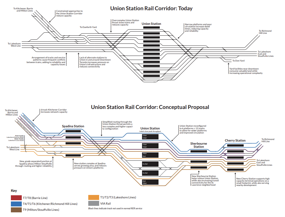

Is this reconfiguration of Union possible? How would it even be done? Anyone have a platform level layout?

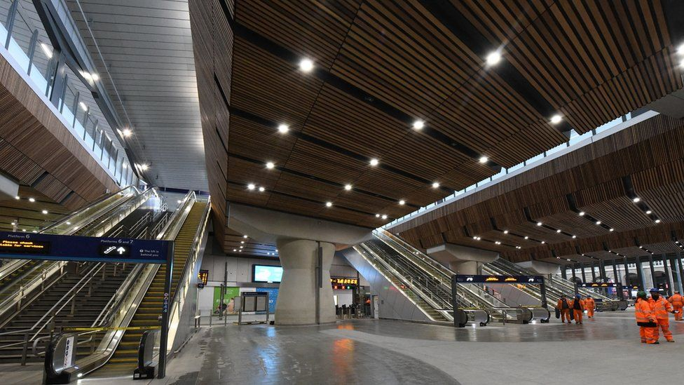

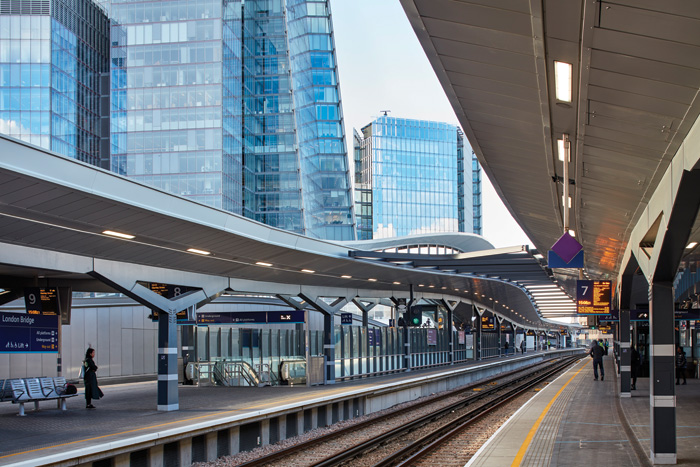

Judging from the reconstruction of London Bridge Station to get the wide platform and double track layout

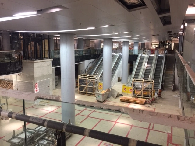

The Concourse columns would have to go from this
to this
It probably could be done but knowing Ontario construction would take 20 years.
The main focus of this photo isn't even the concourse; it's the Food Court. The 4 escalators in the photo don't even go to the platform. All the concourse to platform access in the York Concourse are all tiny circular stairs and elevators. Replacing them with proper straight escalators would be essential for electrified frequent service. Am I correct here?
I see a lot has change in 14 years regarding stations for Cherry St. When we did the EA for Cherry St redesign and streetcar line as well look at the extension to the Portland, Metrolinx was only looking at a few platforms and the RH line wasn't going to stop there. I thought it was dumb not having RH trains stopping there to have access to the Portland than going to Union.
There was never any indications there were to be stations at Sherbourne since the feeling of Metrolinx that the stations at Cherry St would slow service down. Don't see those stations taking pressure off Union.
Metrolinx saw trains ending at Spadina which was a big issue for everyone as it required longer travel time to get to Union and the city core.
The corridor for the Weston Sub was to be 8 tracks, built that way and then 4 at the Barrie/Milton split. This plan is saying only 6 tracks will be use in place of the 2 for Barrie, 2 for Milton and 4 for KW/airport. From the Split to Bramalea, the corridor is to be 4 tracks with most of it in place. I guess building the 4 track tunnel for the West Toronto Diamond Grade Separation was a waste of time and money.
In time which is now, that 5th Lakeshore W line will be needed along with a 6th to Willowbrook area and then 4 to Aldershot/Burlington.
That's probably true, but those columns are the ones holding up the tracks. If you wanted to go with wider platforms and have two tracks next to each other like the report suggests, then it would require those columns to be doubled and/or another complete overhaul of the concourse.
Unfortunately, from what I remember the Spadina RER station is only supposed to support Barrie trains no?
In the near term, yes. Adding platforms for other lines (like LakeShore or Kitchener) probably requires shifting the flyover to another location.
The most interesting feature of the Spadina GO stop is the roof (a section of the Rail Deck Park).
to this
You don't actually need to change the columns, you need to do some cantilevers, which already exist at Union iirc. It will still be a lot of work though.
