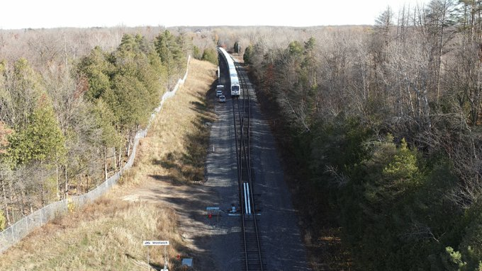

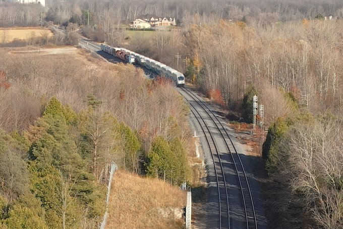

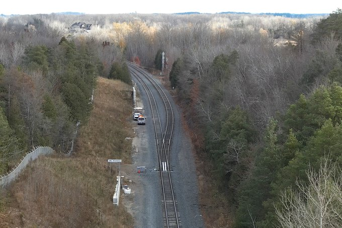

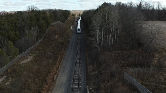

The new GO platform is not ready for use, because the track going to it is not tied in. Last I checked, things haven't changed from these pictures I took in July.
Speaking of the Guelph siding, some (non-)progress pictures from today. Retaining wall has been done for a long time, but the ballast and track assemblies still lay piled.
