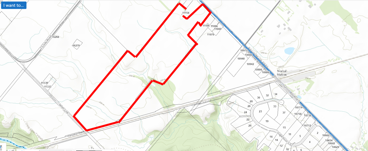

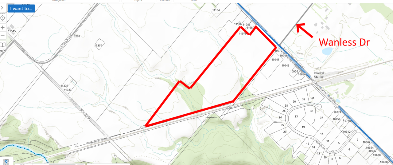

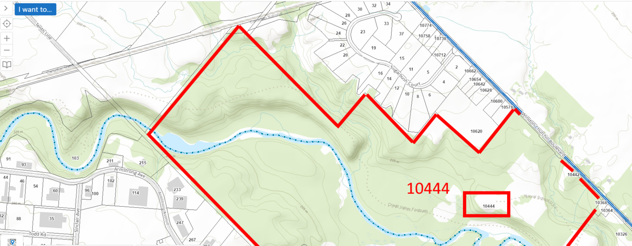

1] This is a Report to the Expropriating Authority, Metrolinx, following a Hearing of Necessity at the request of James Reed with respect to his property SE 10 Line & RC, and NW Winston & Wanless, and E10444 Winston Churchill Boulevard, all in Halton Hills, Ontario (“Reed lands”).
Found the case and the addresses

This would put the parcel in/about here:

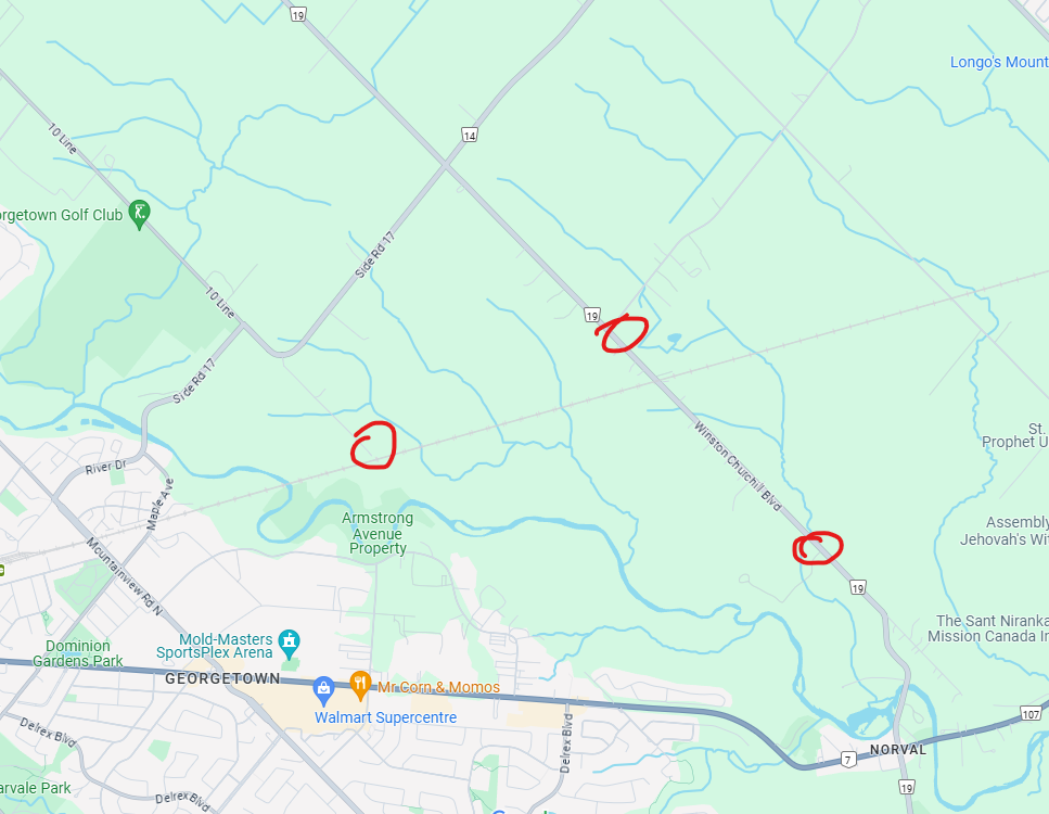

if im reading this right, this is the 3 locations mentioned.
10444 winston blvd
10th line somewhere
winston and wanless intersection
Can someone fill me in on how this relates to the silver junction flyover? That is what the project is right?

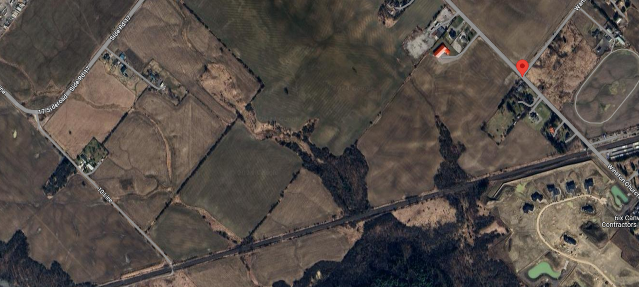

Portions of these parcels and probably access roads for construction, are required for the rail grade separation.

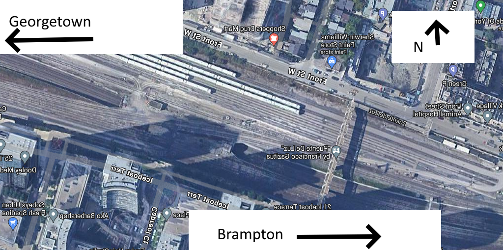

I assume it'll look like the one between Bathurst and Spadina, but inversed.
Cannot see 3) 10444 Winston Churchill Blvd land been use as there is no room for a yard and next to the Credit River
The only thing 2) NWWinston & Wanless has going for it as a yard is that it has less impact crossing roads
1) SE 10 Line & RC (I wonder if that means "rail corridor") is the preferred option for a yard as it has more room, but will intensifier with the road crossing and close to the Credit river and the bridge. Good opportunity to build the 3rd track bridge for it, though the south side is already in place for that 3rd track bridge. Having the bridge to the south free up the north track for GO
