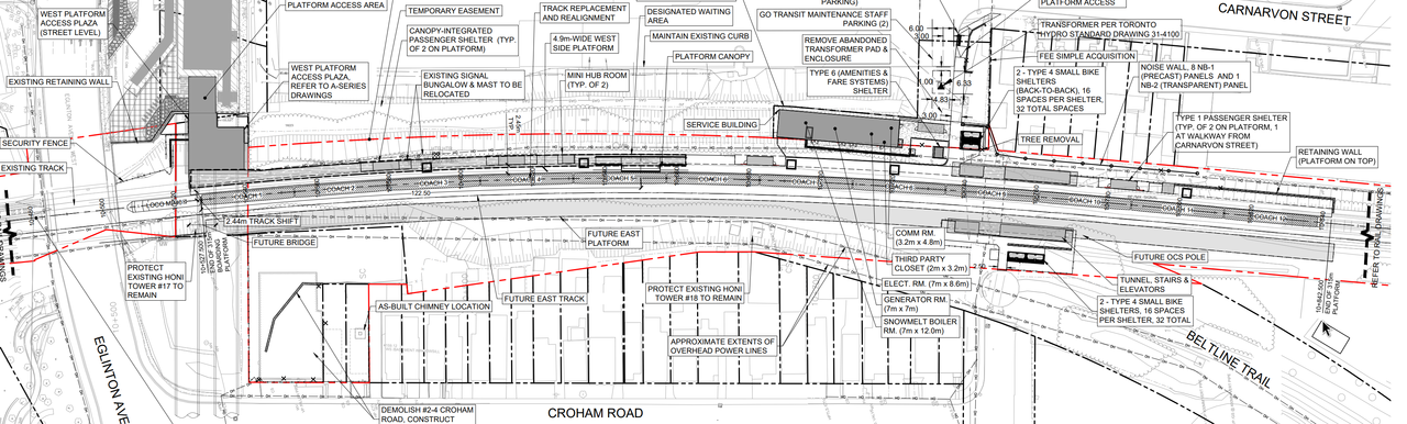

My question is why? We are already double tracking the Barrie Line with side platforms, and according to the information this will take 4 years to build (so earliest finish late 2028). The explanation by @crs1026 implies that they're thinking of triple tracking the station, which would be somewhat understandable, however the Architectural plans, available as part of the development application available on Toronto's Website (dated December 1st 2023) shows a double track station with no room left for an express track:
So, something's not adding up here.
Link Available: https://www.toronto.ca/city-governm...=5201677&pid=696234&title=2322-EGLINTON-AVE-W
(You may need to refresh cache {ctrl+shift+r} in order to load)
