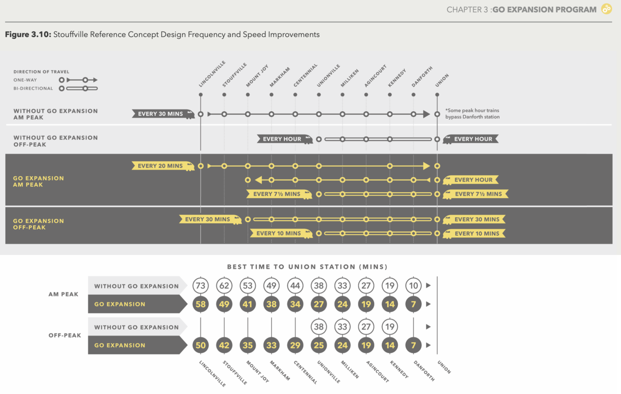

What are the planned frequencies for the Stouffville line? I hope they're robust, otherwise this proposal would end up pushing away local riders that live north and south of Unionville instead.
The frequencies they’re planning aren’t publicised yet, the 2018 business case is inaccurate but I guess that’s the only source for you to go off of
From the 2018 Business Case, no doubt much revisited and impacted by Smarttrack since then
