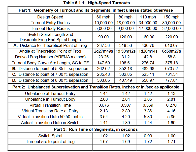

Can you elaborate on this? What's a "speed turnout" and what's a "#20"?
How much of a speed increase will the #20's offer over the existing crossovers?
I will leave the speeds on existing turnouts to others........
But a #20 generally permits a speed of up to 45mph in the cross over ~72km/ph. * there are factors that cause this to vary.
Here's list of some North American turnouts and their speeds:
Here's the more complicated math, which I will leave others to explain:
The above is from : https://hsr.ca.gov/wp-content/uploads/docs/programs/eir_memos/Proj_Guidelines_TM2_1_3R00.pdf
