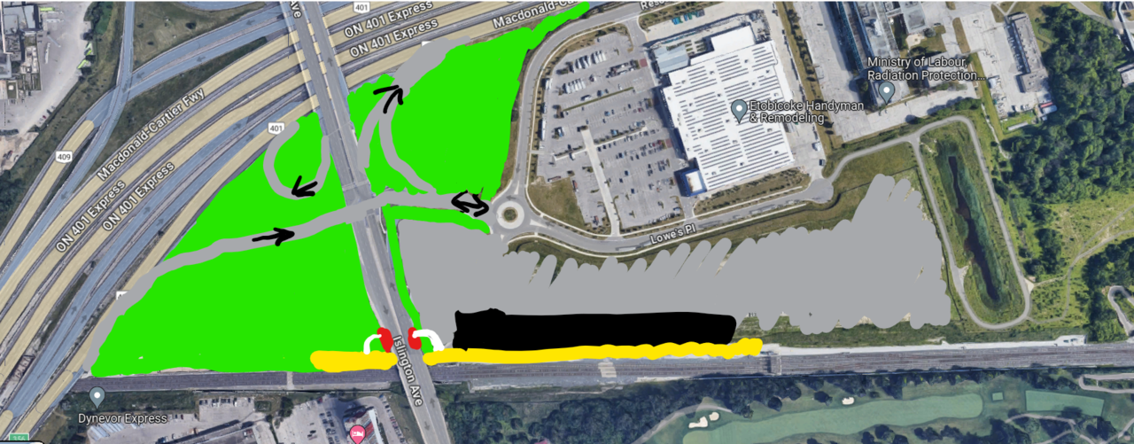

At Etobicoke North, the roadway is depressed from the sidewalk, making a bus stop there impossible. Meanwhile at Islington, you could put a stop on the bridge and have walkways down to the platform level. You could even relocate that service road.
Also I don't think you need a parking garage.
Check it out:
Grey: Paved surface
Black: Station building
Yellow: Platform
Red: Bus stop
White: Pedestrian path
Check it out:
Grey: Paved surface
Yellow: Platform
Red: Bus stop
And where exactly are people going to stand waiting for those buses? On the bridge sidewalks?? Pretty sure there's a mandated minimum amount of space required for bus stops and that would fall well short of what's needed for a basic stop, nevermind being able to service the huge deluge of people coming off of a train.
Check it out:
Grey: Paved surface
Yellow: Platform
Red: Bus stop
Your ramp placements are way too tight. MTO is not going to agree to that eastbound off-ramp redesign since it's much too short and liable to back traffic up on the main section of the highway.
