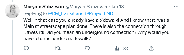

the main - danforth connection seems like low hanging fruit at first, but the reality is that it's not *that* close and crosses several different property ownership groups which makes it challenging.
If the TTC / Metrolinx ever wanted to make the connection, they would likely have to do it via a long excavated tunnel underneath Main St, which wouldn't be cheap.
I’m not sure what problem we are trying to solve here.
It utterly makes sense that the two transit nodes be connected. But they are today…. by a sidewalk, albeit iirc with stairs and/or a ramp.
A more climate protected pathway would be an improvement, and if there are accessibility barriers these should be addressed (I have used the route myself, but never really focussed on accessibility so I’m no expert on its current usability). That doesn’t necessarily imply HVAC or moving sidewalks.
There are many pathways on our transit system where one must use their own power to travel a long distance. PATH comes to mind. Adding powered walkways is an improvement, and a convenience at times, but a secondary priority for allocating scarce funding IMHO.

I believe you're looking at the height of the building at 2681 Danforth. Measuring on Google Earth, a pedestrian tunnel between the GO and TTC platforms would be closer to 300 metres.
It's not impossible but at the same time not nearly as important as Bloor/Dundas West (which looks like it would probably be about half the length). When you're on the Danforth platform it's pretty easy to find Main Street, and then you can just cross Danforth and follow the streetcar tracks until you find the subway station. At Bloor, I most often see people cross the FreshCo parking lot, jaywalk across Dundas, and dodge buses exiting the loop to get into the station. It's pretty embarrassing that the transfer has been this janky for so long.

It's just a dumb Twitter 'urbanist' take. It's not gonna happen:
The tunnel along Main Street would be six times the length of the planned tunnel between Bloor GO and Dundas West TTC. The Dundas West platforms stretch 134 metres east from the current entrance, so the new tunnel from the east end of the platform will only need to be about 50 metres long.
That will be an enormous improvement over the current transfer which is about 350 metres.
At Main Street, the only place where you could conceivably build a tunnel is right under the existing sidewalk. So the only distance saved would be the length of the escalator heading down to the mezzanine in the station. Eliminating one at-grade street crossing, reducing the vertical displacement and providing weather protection are of course benefits, but I doubt that those alone would ever justify the enormous costs of such a tunnel given all the other transit improvements we could get with that money instead.
