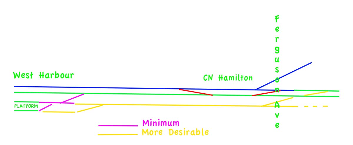

Seeing as I'm deskbound on a snowy afternoon, here's a notional junction layout for West Harbour.
The bare minimum (purple) would be to join the two platform tracks and then join that directly to the current main line. (shown in green)
A better design,(yellow) to reduce conflict with CN, and anticipating that there will one day be a third track all the way to Confederation, would also put a new track from the platform all the way to about Wellington St, with new higher speed crossovers east of Wellington so that trains on either main line could enter the new track. That gives the potential for two track operation into/out of the depot (if CN would allow that) and it keeps GO clear of the junction with the lead to the industrial areas - which remain quite busy. More costly, yes, but more effective.
If I remember, there has to be a 3rd track and 4th track to allow for a centre platform between them with side platform and leaving CN free to bypass the station what I saw on site.
To have a stub track as per your plan, a centre platform has to be built between CN mainline and the plan stub track. This allows GO trains to get to/from the Lewis yard with a crossover to the other CN track. I can't recall if a crossover was installed during the track work at the time. It also allows GO to access to 3 tracks for the station and only using CN tracks or adding a 3rd track to the next GO Station toward NF.
