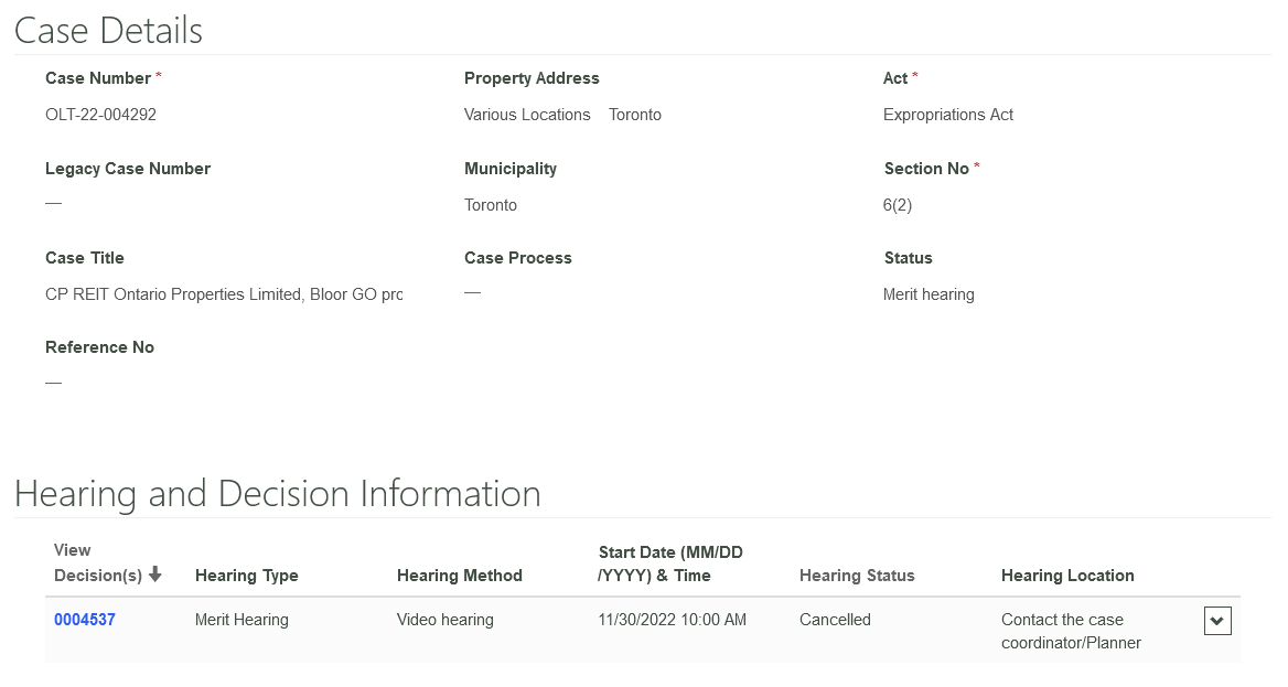

Hadn't seen this from Metrolinx, but I might just be late to the game:
Muddling through OLT files, cause what else does one do on a day off, when the weather is at it is.......? LOL
I came across this; and wondered, do we know about this, did I forget about this?
^ Was this about the connection between TTC Dundas West and GO Bloor?
It was always understood that the government had begun to expropriate as negotiations weren’t successful.
Once the project got traction, the end settlement has dropped out of sight.
- PUl
Does the cancelled hearing indicate that negotiations resumed, or is it more likely to just be that it's been postponed for whatever reason?
