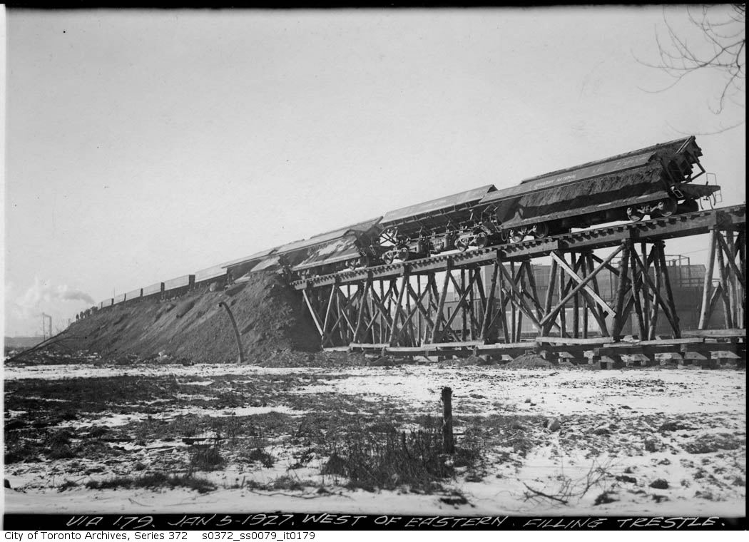

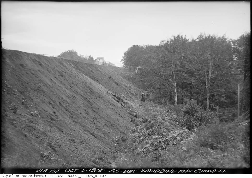

Dan, I've searched extensively for any photographs before the 1920s, and I'd be very interested in seeing what you've seen! As far as I know, the last major work on that embankment was in 1926 (see picture below, looking east from the southwest side of the Smalls Creek).
For the record, the same technique was used to raise the tracks into Union Station from the east - that was done in the 1920s, and there is no sign of any of the wood from that construction.
There's a good photographic record of that work - as far as I can tell, that work was done about the same time as these photos were taken. From around Pape to Union they appear to have built a trestle explicitly for building the embankment, dropping the soil from railcars, to fill the embankment. (which makes me wonder how good the compaction is).
I'm surprised there'd be no trace left of the wood after about 100 years. I've done drilling before downtown south of Front Street, and hit large pieces of timber, which must have been of a similar age, and below the water table. I'd think the old trestle, mostly above the water table, would be better preserved.
The Grand Trunk began double tracking the Toronto-Montreal line in 1887. Perhaps that's why and when any trestles were filled in.
Ah, that's interesting - perhaps related to Dan's 1880s photos. Yes, it could have been done then. Though that's an awful lot of soil from that early - though it's just about the time of the advent of steam shovels - I'm not sure when they started to be used locally.

There's over 600 photographs of the 1920s viaduct (embankment) construction online in the Toronto archives - Fonds 200, Series 372, Subseries 79
The subseries is called "Waterfront viaduct photographs". The 1926 Small's Creek photographs are part of this series - though obviously built before 1926, given the vegetation (which is now covered with trees - or at least was before Metrolinx started the recent work).
