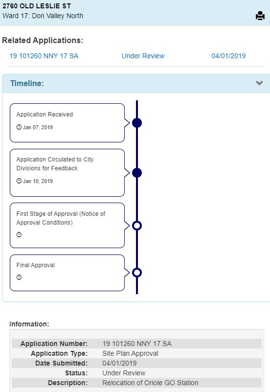

I was under the understanding that the Oriole move was required to rebuild the 401 bridge over Leslie - which is happening very soon. I recall Metrolinx going as far as filing a site plan application for the new station and everything.
Yep. It's filed under the address 2760 Old Leslie Street. Here's the application timeline, from the City website:
I can't seem to get a static link for that application's home page, but if you search that address in the City's Application Information Centre, you can find links to architectural drawings for the new station.
There's plenty more where this came from:
