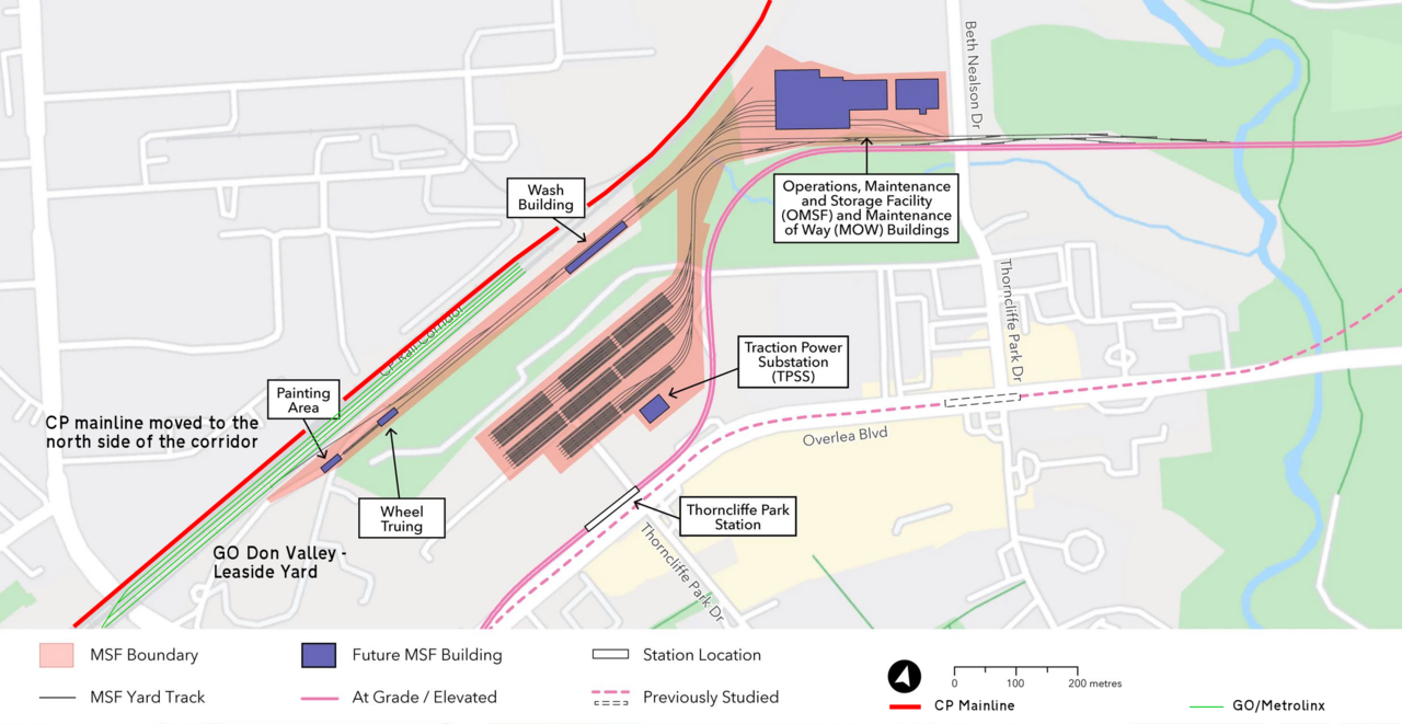

Don Valley Layover - Public Meeting. Co Hosted with MPP Peter Tabuns and Councillor Paula Fletcher
Seems like it would be an easier sell to use an underused rail yard as a rail yard. Why not have the trains continue up the line to Leaside, avoid needing to impact the valley as much with the parking lot and service building, but instead only keep the tracks and upgrade them to operating condition.
The answer is $$$
Reactivating the Don Branch would mean restoring/rebuilding the 1/2 mile bridge across the Don Valley (its in rough shape); as well as rebuilding all the applicable track, and probably putting signalling in as well.
That's also presuming CP would offer up the yard; which would then need to be leased or purchased, as opposed to the Don Branch tracks which Mx owns.
Don't get me wrong, its a fine thought......
There is no CP yard there anymore but pile of used ties. I don't think that spur is used anymore. What was an industrial area at one time is turning into big box and residential.
You have a car wash next to CP tracks and a sub station south of it and that is all there now.
I won't lie... I dream of the day that trains will run over that viaduct again... hopefully sleek shinkansen type models whisking people to Ottawa some day, but GO diesel fleet headed to park in the Leaside yard for now seems like an attainable goal.

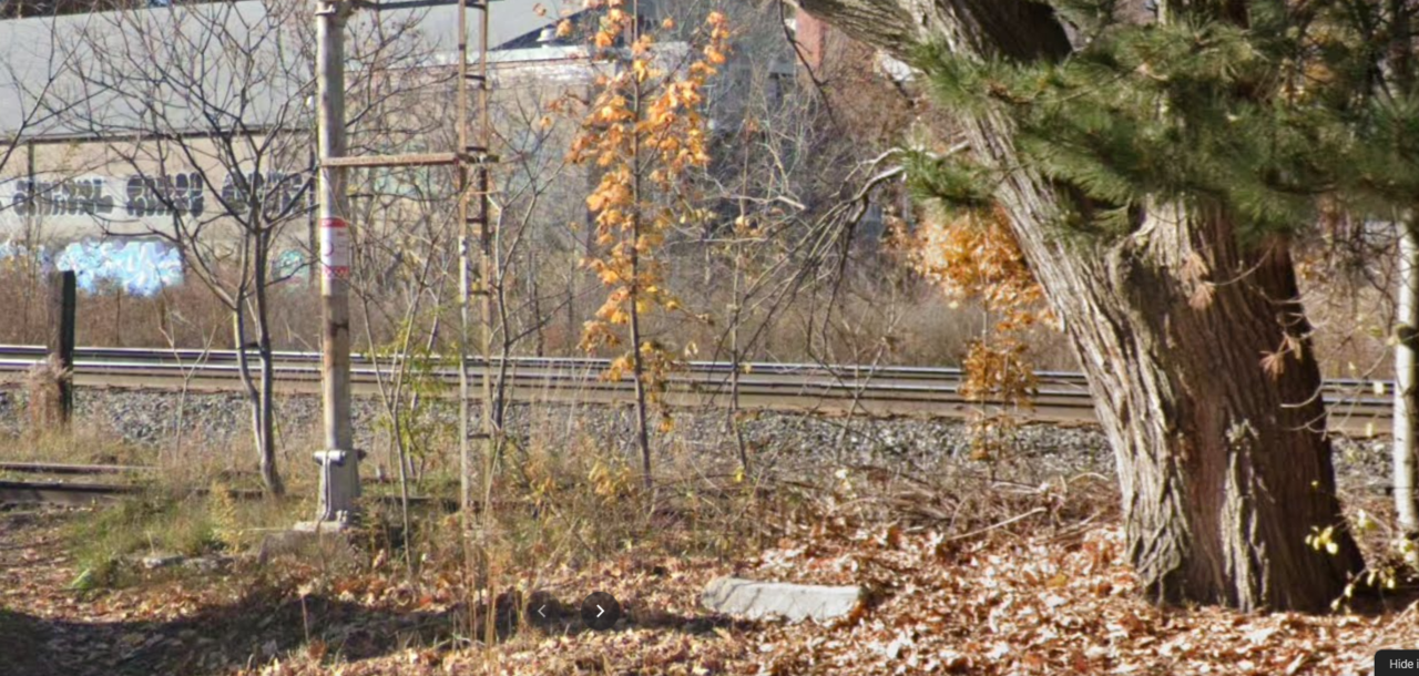

From November 2020:
The above 2 are Streetview, from the Arena parking lot on the north side.
The below is from the south side, on Redway Road:

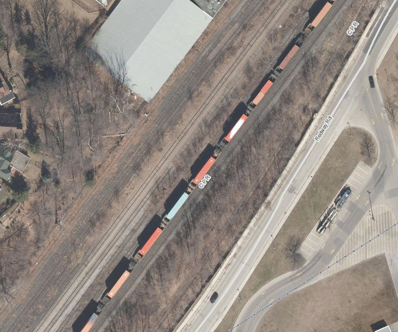

Most recent aerial for sure, is TOMaps which dates back to 2018:
From November 2020:

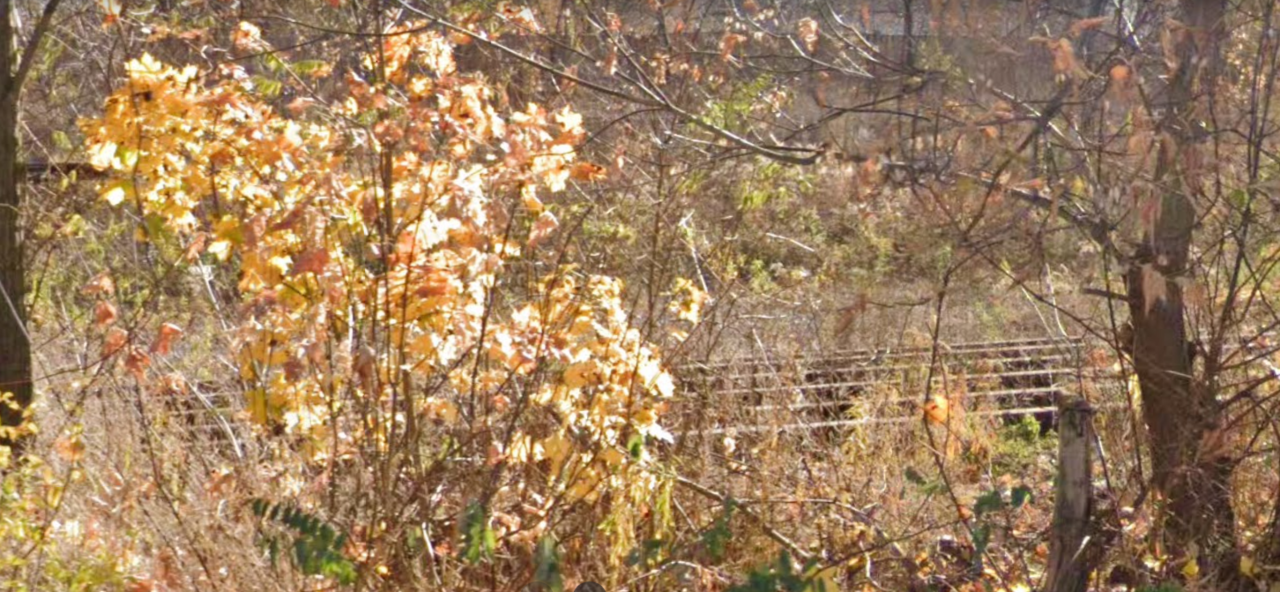

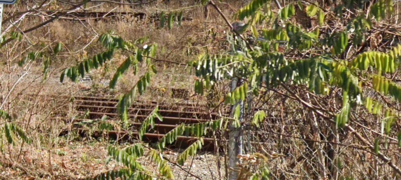

I was at the carwash area last week and saw no tracks other than the 2 mainlines and rows of ties on the north side. The ties maybe hiding some tracks, but the area hasn't been use as an yard for decades. I remember in my young days seeing cars in the yard as well the switch to the Don Valley Line.
Was going to check the west side but ended up not doing it. Never venture east where the road ended.
Did take some photos and starting to work on the photos for April 11.

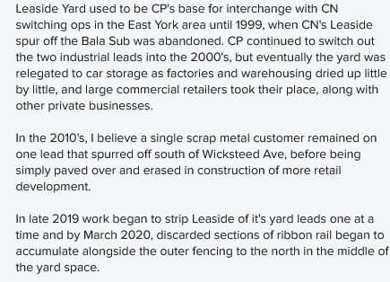

It hasn't been THAT long. I saw trains there maybe 4-5 years ago.
Took me awhile to dig it up......
I found a Torontoist article showing the yard was active in 2010.......
But this is better:
From the above:
