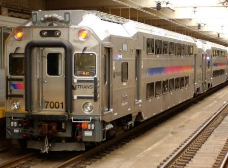

Compared to the United States, our commuter trains look pretty good in comparison. For example, the newer Multi levels on NJ Transit look like trains from the 70s IMHO.

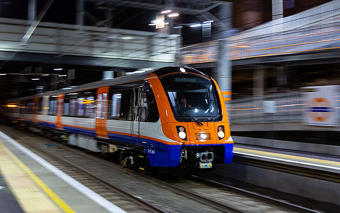

Can we order those bombardiers that they use in London?
Leave US aside. They are as bad as Canada.
