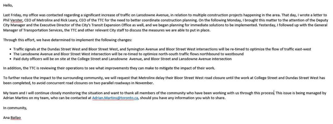

What Metrolinx construction is happening in this area? Is the planned Metrolinx closure of Bloor St W related to the Davenport Overpass or the Kitchener Line 4th track? I assume it's the Davenport Overpass? cc @crs1026
TTC is doing work in the Dundas/College/Lansdowne area for track and overhead. They finished the Howard Park Intersection.
Metrolinx needs to move the east bridge over Bloor St for the 4 track aka track 1 that will require a closure over a weekend.
There is most likely some traffic movement for the Davenport work.
At the end of the day, traffic is and will be an issue regardless what is taken place due too many vehicles in the first place.
