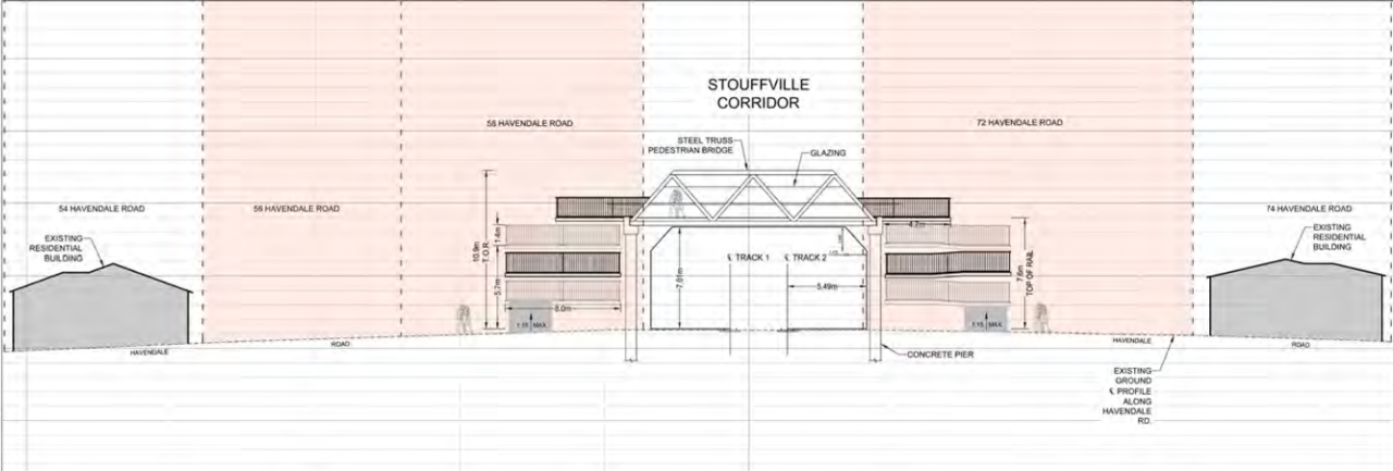

It needs 7m clearance based off the Havendale pedestrian bridge proposed (which will close Havendale crossing and tear down 2 houses). That would make the grade 3.1% which from my understanding is ok for Passenger Trains. Won't see any freight trains ever use it. Which then leads us back to that rail spur - if it stays that is going to be a switching nightmare maybe. It does make me wonder how trains are currently shuffled to it.

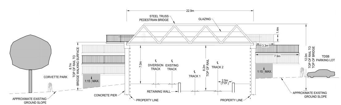

this picture I posted before shows there will be a diversion track:
and the unpreffered tunnel option provides an even better view of the diversion track:

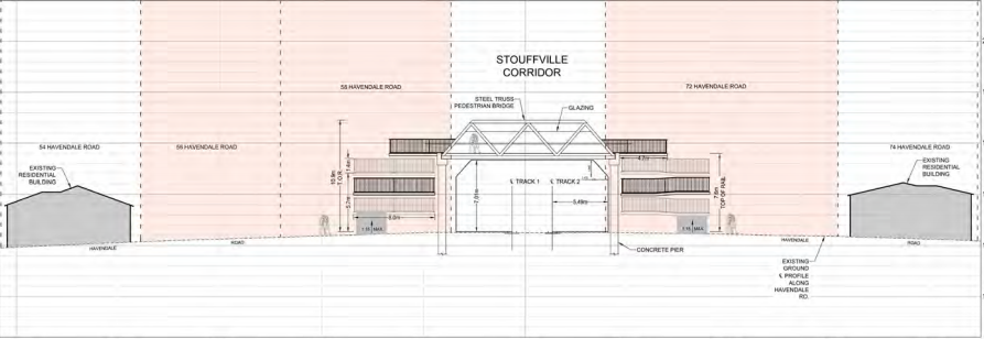

compare this to the half the length havendale ped bridge:
It does make me wonder if they will ask the community if they can go a couple years without the corvette crossing to build a cheaper bridge.

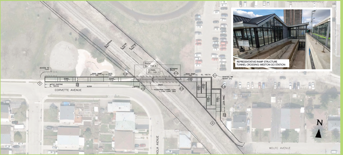

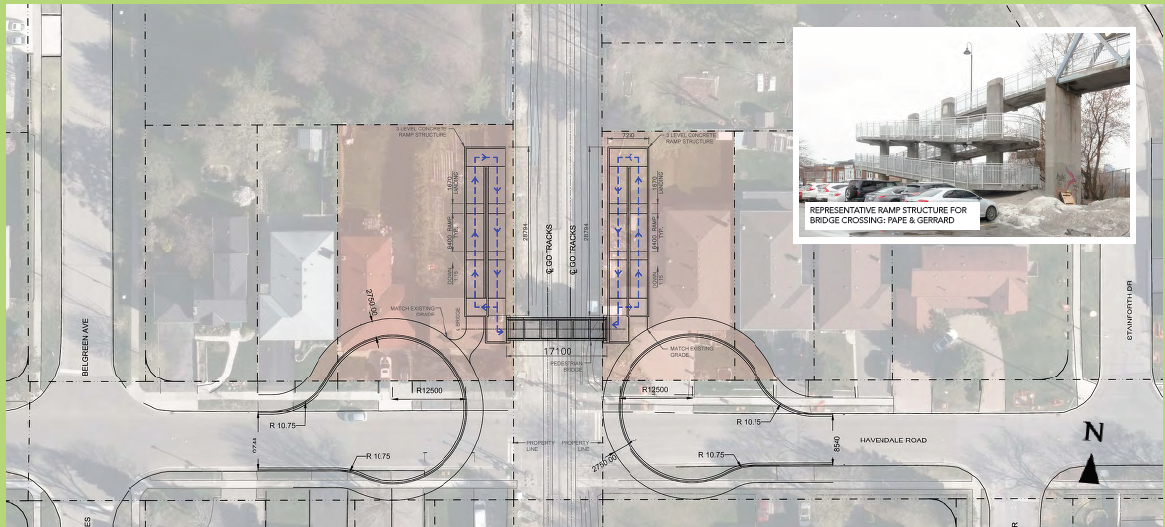

Also regarding havendale.. yes tearing down 3 houses, chopping the front yard off a couple houses and check out that one house that is slated to have a couple inches between it and the cul de sac:
and all this to build one pedestrian overpass that I'm guessing is to facilitate access to the park:

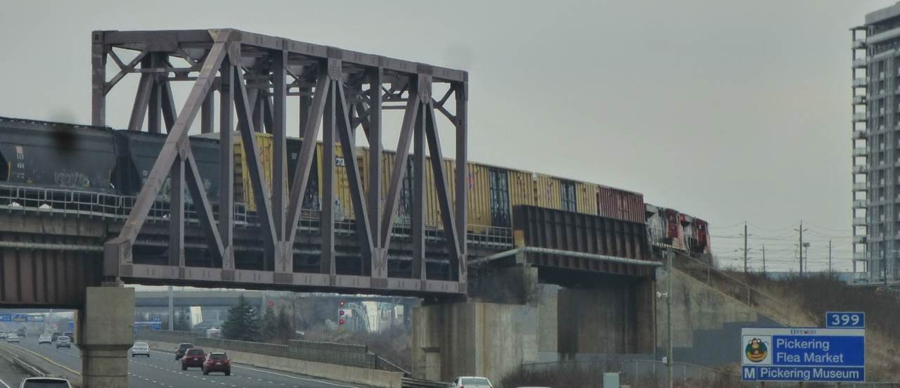

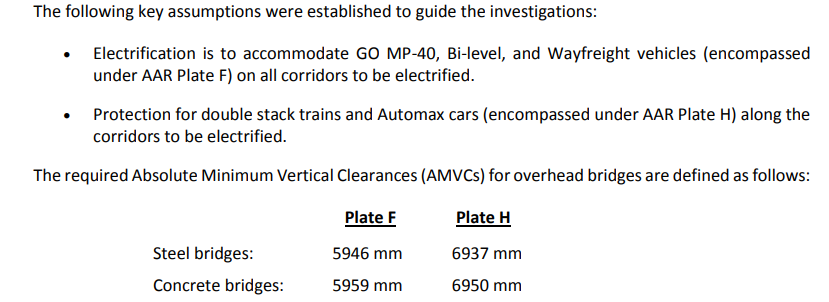

That's enough for a truss rail overpass with room for OCS underneath. GO electrification minimum clearance is 5946mm (19.5 feet) if you custom build it with the right materials, plate, etc.
(source)
25feet can be doable with 19.5 feet clearance + 5.5 feet rail deck underneath trussed bridge or (set of) bucket decks.
Tolerances are tight but should be doable without violating Metrolinx slope specs, and I've seen railroad truss bridges thinner than 5.5 feet from bottom-to-rails by using a slim railroad deck and a truss to stiffen a thin rail deck bridge. If you've driven east of Toronto on 401 through Pickering, you will often see this weird combination of 3 different rail bridge deck thicknesses:
-- Traditional I-deck at left
-- Truss bridge in middle
-- Bucket deck at right
(source -- http://beachburg.blogspot.com/2015/01/railway-bridges-of-ontario.html )

That’s some napkin.... two percent at seven hundred feet is 14 feet in elevation. Three percent is 21 feet. ML’s preferred vertical clearance for electrification is 7.584m or 24.9 feet. The overhead beam structure will need a couple feet of depth. Railhead to railhead, we are talking 27 feet or more.
