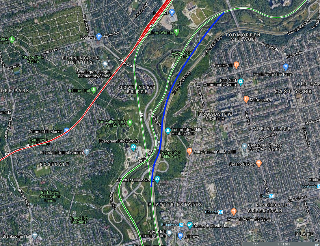

So a route similar to this? See the blue line. How far north would it go before it would meet back up with the Richmond Hill line?

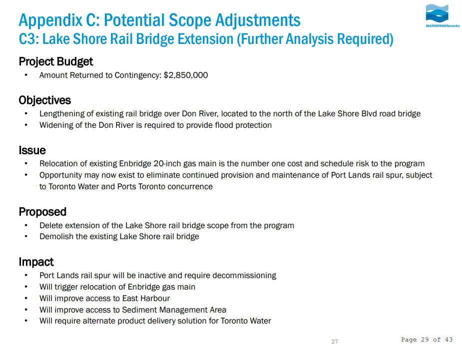

This may be related to the apparent move to abandon the Portlands/waterfront spur
The number of times that "went missing" in Unilever and Gardiner renderings...

@Allandale25 I would think they would want to hug the DVP all the way round to the Leaside Bridge if only to keep down the number of river crossings. The Ontario Line Don Crossing could influence available options too.
I never saw a map, and I don't know how far along conceptual modelling was ...........
From discussions with various parties, my impression was that the tracks would reconnect into the existing Bala not that far north of Pottery. In my head, I was thinking where the alignment is close again, 200m or so north of Pottery.
But as I said, I never saw a drawing, formal otherwise.

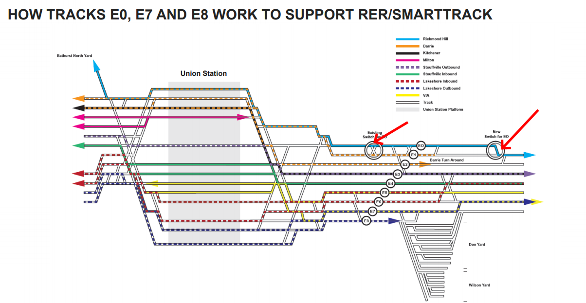

I wonder if part of the rationale for this new layover is that they need trains on the north side of the USRC East and the Wilson Yard is on the south side. I wonder if this layover will specifically be for Barrie Line trains? cc @crs1026 @smallspy
Image below from a presentation from March 2018, but the E0 extension isn't being built (red arrows added) at this time per this presentation in May 2019.

This may be related to the apparent move to abandon the Portlands/waterfront spur and the associated rail yard. There is clear talk about improved access to the Unilever site, which would imply no tracks at all north of Lakeshore, east of the Don.
To the best my knowledge, there are no plans to abandon the Portlands trackage. Indeed, that decision would rest on Ports Toronto and whatever they have planned for the area, and not Metrolinx.

^ I haven’t seen with my own eyes, but I’m told the harbour spur has in fact been ripped up east of the Don bridge.
It's been decommissioned for a while past Canadian Tire at Leslie as they ripped it up to build a new Canada Post building. Canroof is the only one with an active track connection still because of that, and I'm not sure they even use it. Toronto water, the main customer on the sub, has been cut off as a part of that construction, and while there has been talk of "realigning" it along leslie beside the Canada Post building, not much has happened on that front. I would be surprised if it isn't ripped up in the next year or so, to be honest.

I wonder if they have notified the couple of industries that still use the spur. The City apparently had to beg in order to arrange for trucking to and from the Ashbridges Bay plant for the interim period whilst the spur was torn up alongside Leslie.
The also raises the question - is that realignment of the spur still going to happen? There hasn't been any indication at the City end that it isn't going ahead.
