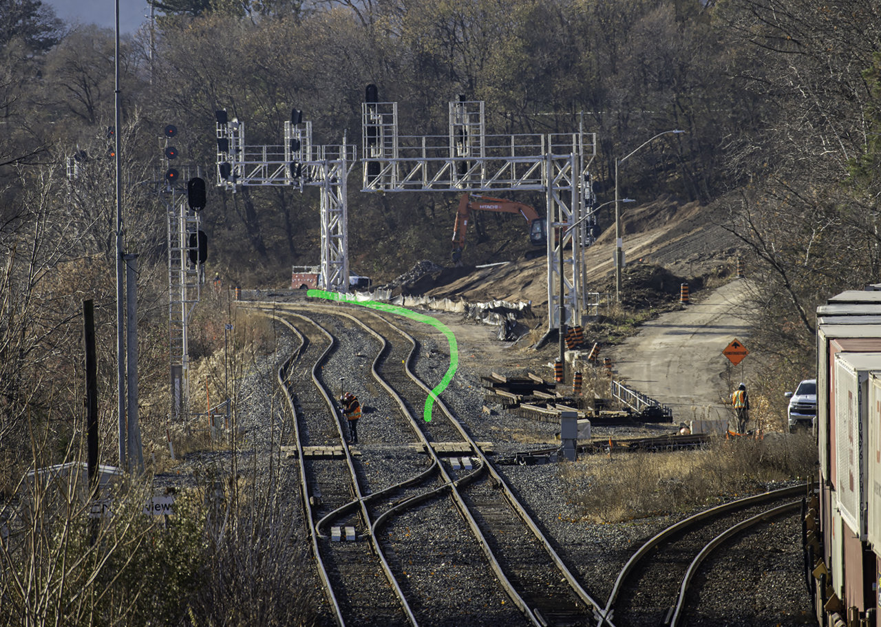

A shot of activity today at Bayview - looks like the turnout for the new third track to West Harbour is ready to be installed. Then comes the tracklaying. So nice to see this coming together. I'm told they may straighten out the kink in the tracks while they are at it.
The earthmoving on the north side that was commented on previously simply appears to be easing of the slope of the bank. I wonder whether new fencing is about to appear.

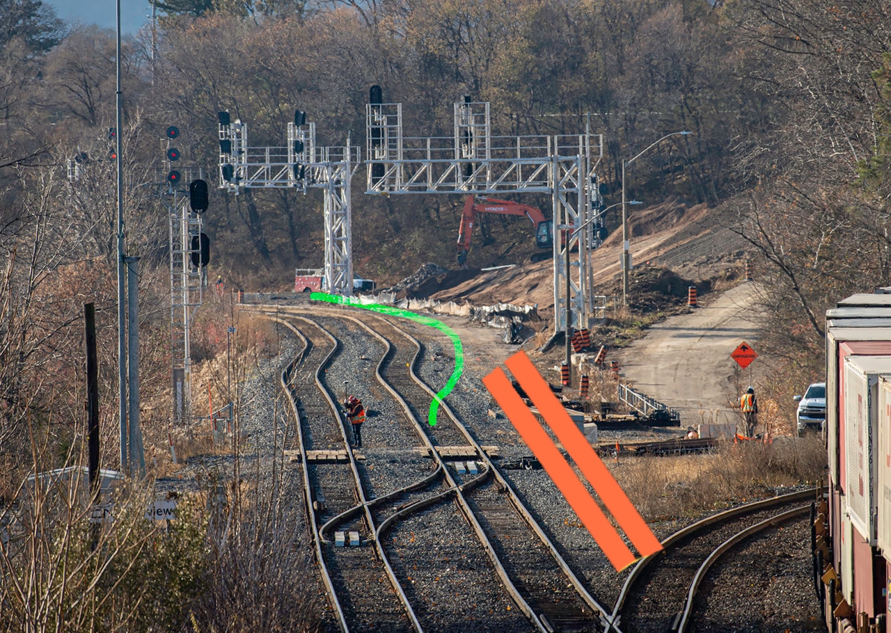

^ Just out of curiosity, why wouldn't they try for something like this? I assume there's a civil engineering reason relating to switch angles? Maybe even signaling? It's just tempting to draw a straight line extending the soon to be built third track cc @smallspy
^Without measuring clearances or curves, that alignment would be exactly what CN would not want. The whole idea of the crossovers is to keep GO on the south most track, and to minimise conflict between those movements and London-bound trains (whose route diverges to the right).
The track alignment at Burlington and Aldershot is all about keeping freight on the north and GO on the south. This aligns to that.

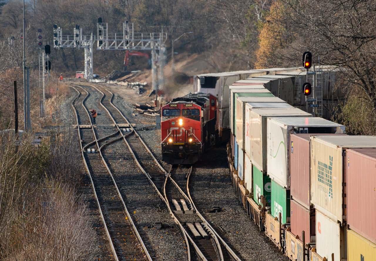

^Just to illustrate my point - just a few seconds after I took the above picture, this happened. See how CN relies on having both of the two London tracks available much of the time. There is a route possible from the middle track towards Hamilton, and that's used regularly by GO and Amtrak, if CN traffic permits. But running GO on the northmost track, and having it cross over in front of that eastbound, would be undesirable. That's why GO crosses over to the south at Burlington West and stays there until clear of the Dundas Sub.
On top of what Paul wrote, there is also a geometric reason why they won't do that.
Doing so would require the second switch to be a curved wye switch, which is not something that CN normally keeps in stock. Because it is non-standard, maintenance will be a bit more of a pain. As an additional minus, it's geometry may not be ideal for the speeds that CN wishes to operate at.

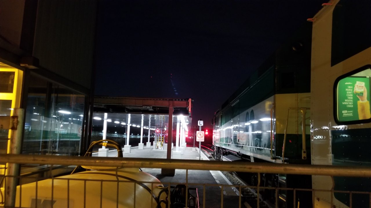

Burlington
Tim's is open at Burlington GO station and Burlington Transit has moved buses back to the new bus bay for them back in Sept. Buses were still on the north side when I was there in Aug. Tim's was very busy and not surprise for this.

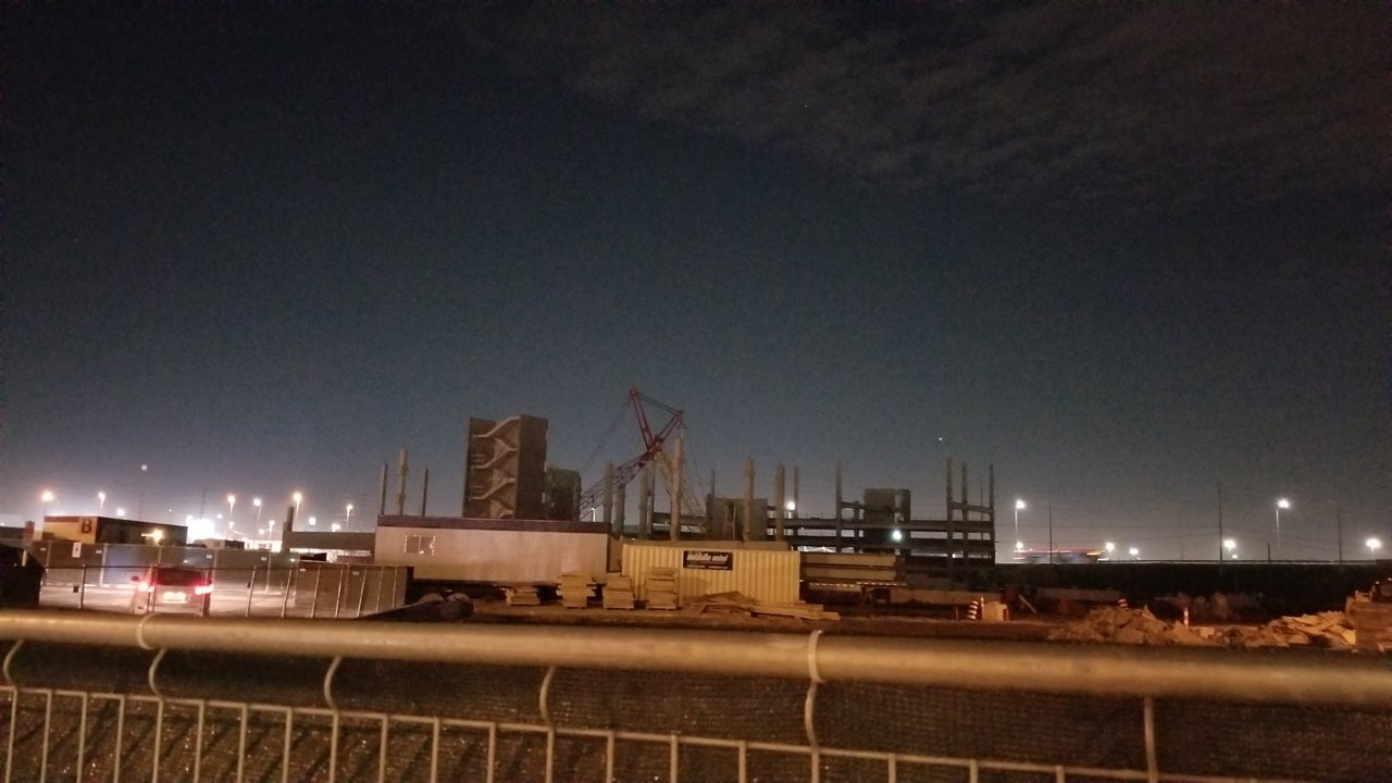

Confederation
Nothing has started on the new Confederation station itself or the tracks, but the bus terminal is done along with a small parking lot. The parking lot wasn't full when I was there.
There are 4 bus stops with GO having 3 of them and Dart for the other one. There is one shelter with a heater in it, but didn't need on today as it was so warm, I wasn't wearing a coat.
A few quick shot for now as they are in a backlog at this time. Not edit, tag or number at this time.
