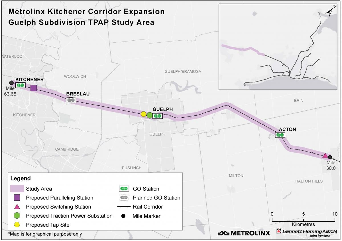

More information here on the TPAP for Guelph Subdivision:
Timeline: https://www.metrolinxengage.com/sites/default/files/kitchener_history.pdf
Colour version of the map.
214164
