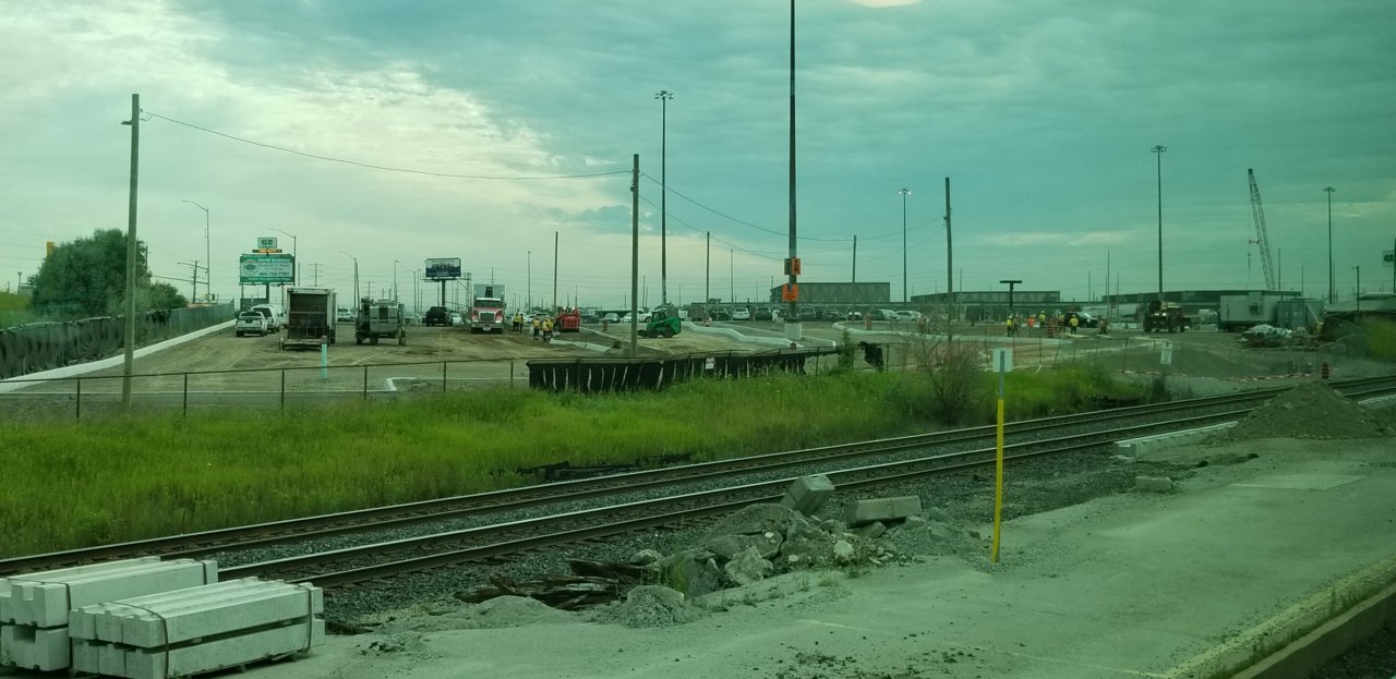

I assume the switches shown here are for the second track?
Yep!...............Until they deal with the junction and the new Kennedy Platform.
