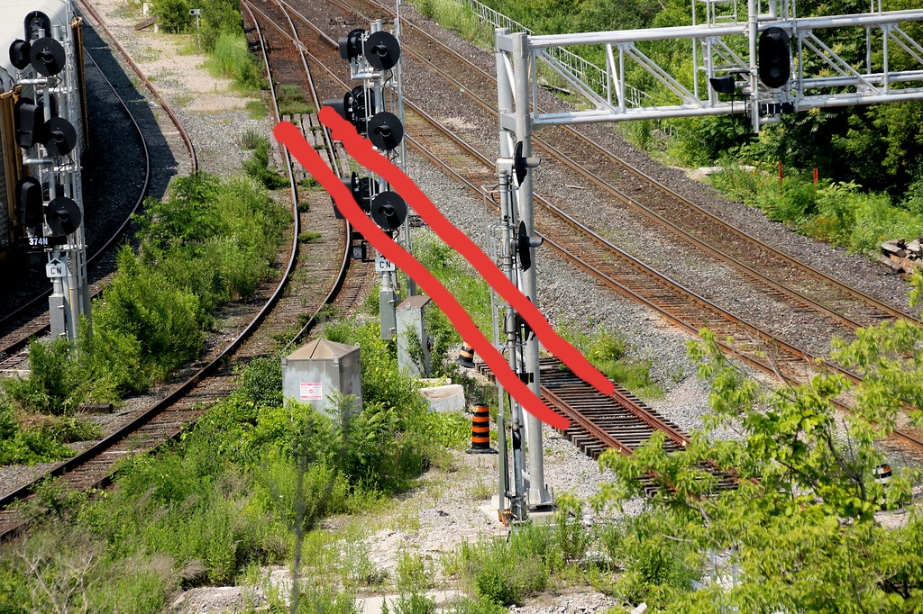

Any idea when the Hamilton Desjardins Channel 3rd track will be connected to the line?
Its up to CN and CP, but mostly CN who have this on the long list of things to be done after dealing with their mainline issues first. Maybe 2020 or 2021 with 2021 time frame due funding cuts and opening of Confederation Station. Others with better info may say something different and my view only at this time.
It’s supposed to be imminent, ie next few weekends. Initially, there will be one new switch connecting the new track to the south CP-CN connecting track (the track that takes.GO to CP at Desjardins). The new Interlocking at Dundurn (where the two tracks coming out of West Harbour narrow to one track) will come on line at that time also.
So this right?
195652
Remind me what this connection permits. It’s part of the ML communication strategy. Draw it out long enough and no one remembers what is supposed to be happening or why.
ML built a new track from Hamilton Jct (where the CP and CN lines through Hamilton connect) to the new station at West Harbour. The theory was that the track would be needed when substantial GO sevice was begun through West Harbour. The track has been there for some years now, but never tied in or used. At current GO service levels it hasn’t been missed, but it will be needed if 2WAD to West Harbour or beyond ever arrives. It’s a white elephant or it’s good long range proactive investment, whichever you like.
The “no one remembers what is supposed to be happening or why” comment is well put, and mostly applies to GO’s internal plan to serve Hamilton. Lots of grand plans, but either no money or no railway agreement or no sense of urgency, or a sudden better idea that restarts the planning, or all of the above.
Oh, and by the way.....the final configuration will need further rearrangement of plant at Hamilton Jct, plus extension to Bayview, before it can actually do what it is meant to do....and GO has no apparent procurement in process to finish the job, so this summer’s work is just a small step, not the end of the job.
