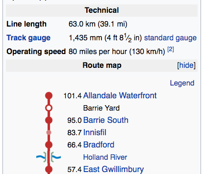

I have edited Wikipedia, using my registered account there, to match correct route length of 101.4km
Barrie line was extended from Bradford to Allandale Waterfront a few years ago, and somebody forgot to update the "Line length" to match the Route map with the extended stations. Surprised that outdated length persisted for so long.
reaperexpress, do you have a registered Wikipedia account? If not, get one! Your edits with good citations should be well trusted by Wikipedia moderators.
Look through the edit history on that very article. I'm embarrassed that in all the years of editing the article I never noticed that error. Thanks for fixing it.

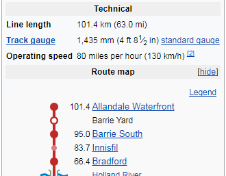

I looked back through the revisions to trace the error, and it turns out my earlier guess was wrong. It wasn't an out-of-date number from before the extension to Barrie, it was a conversion error. The length wasn't 63.0 km, it was 63.0 miles. On 11 February 2018, user Blaixx was updating the formatting of the infobox and misplaced the route length (which was in miles) into the new metric template without accounting for the change in units.
So I'm not crazy after all, that number was still correct the last time I edited the article.

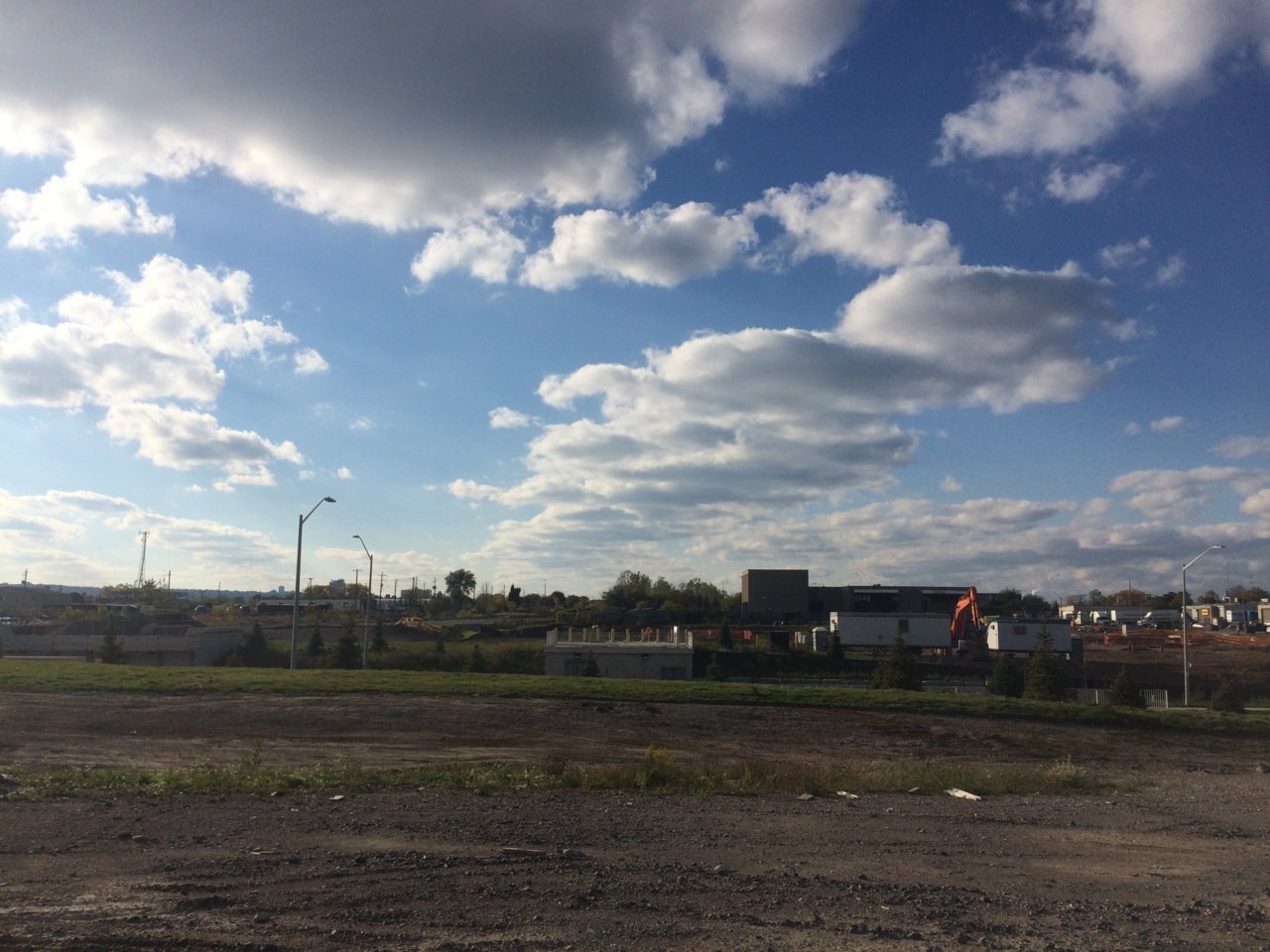

I was at Five Guys in Hamilton this weekend destroying my arteries and managed to snap thisnpick of Confederation GO under construction. So happy they over built the underpass for future rail use.
Wow, I didn't expect to see my 8 month old Wikipedia edit discussed in such detail on the UT forums! Anyways, thanks for the fix!
