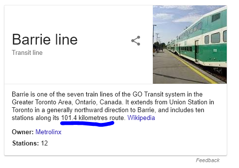

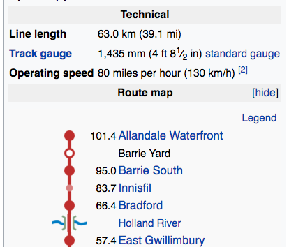

Thank you for supporting my argument. Basically 9% of the track.
Wikipedia has two lengths for the Barrie Line, so I averaged the two of them.
You're welcome. I really have no problem with your argument, I have a problem with your fabricated numbers. Indeed my intent was exactly to restate your argument, but using actual numbers.
Ah okay, I see what happened here. If you look down three lines below that erroneous Line Length in the infobox, you can see the distance to each station. My guess is that the 63.0 km was what the infobox said before the line was extended from Bradford to Barrie (I'm assuming the discrepancy is rounding or measurement related):

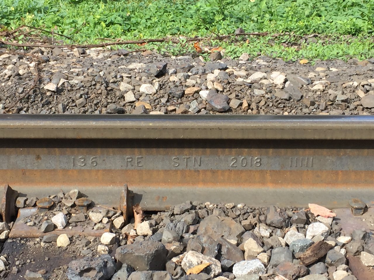

To set your mind at ease - the area through Guelph now has new 136 lb CWR and plenty of new ties - I could smell the creosote the moment I stepped out of my car today. In addition to renewing the switches around Edinburgh Ave, which are used by freight but were pretty worn, the switch at the west end of the former siding at the Guelph depot was replaced with the new one also being 136 lb rail. Crossings still have segments of 115 lb rail, presumably because they are about to be renewed. Much grubbing to improve sightlines. No fencing yet - this will be interesting because the community makes extensive use of the ROW for pedestrian shortcuts and dogwalking. Wonder when an enforcement canpaign will start.
