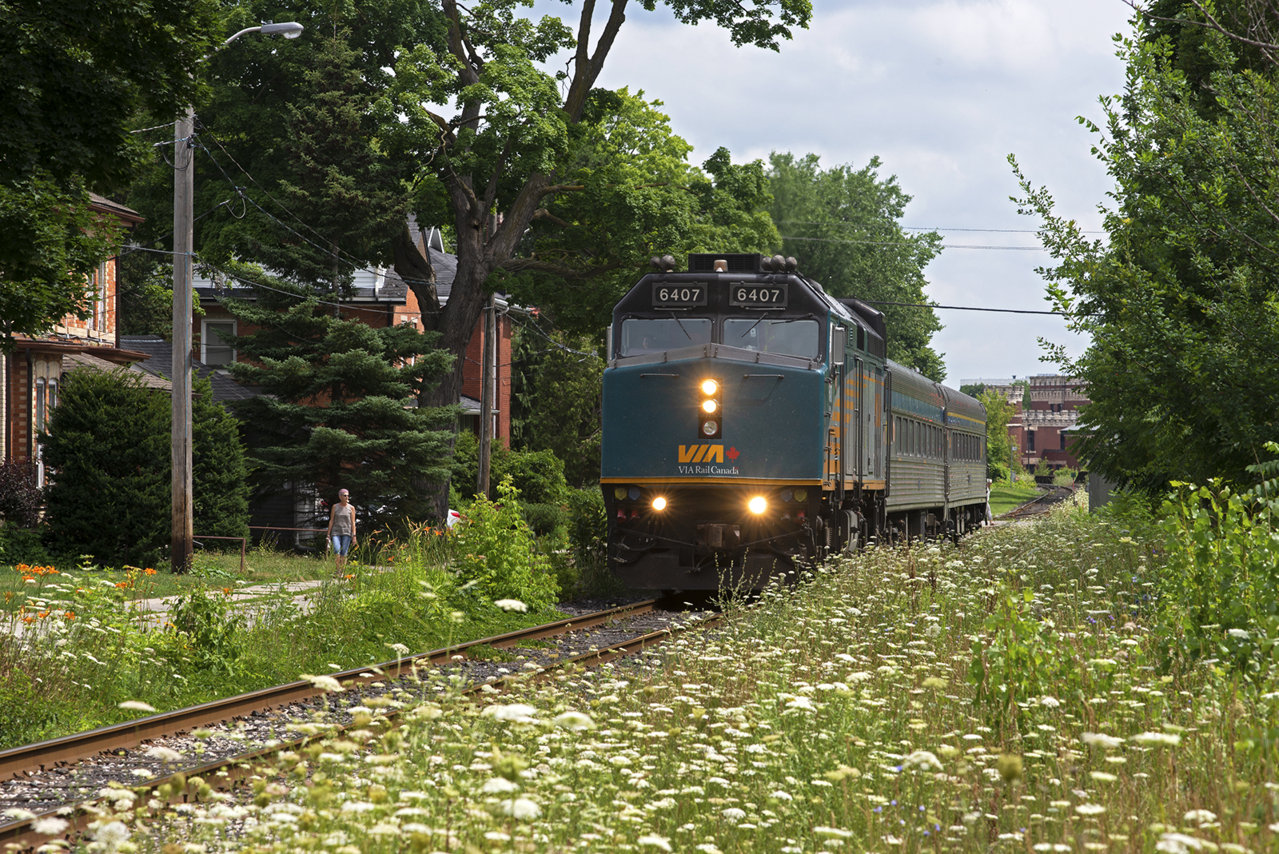

Two pictures from this summer that may help
It's not "moving ballast around" - it's putting down a proper subgrade instead of cinder ballast that dates from steam engine days, in a location that is constrained by concrete curbs, vegetation, roads, etc. And replacing track materials. etc. And fixing sightlines.
