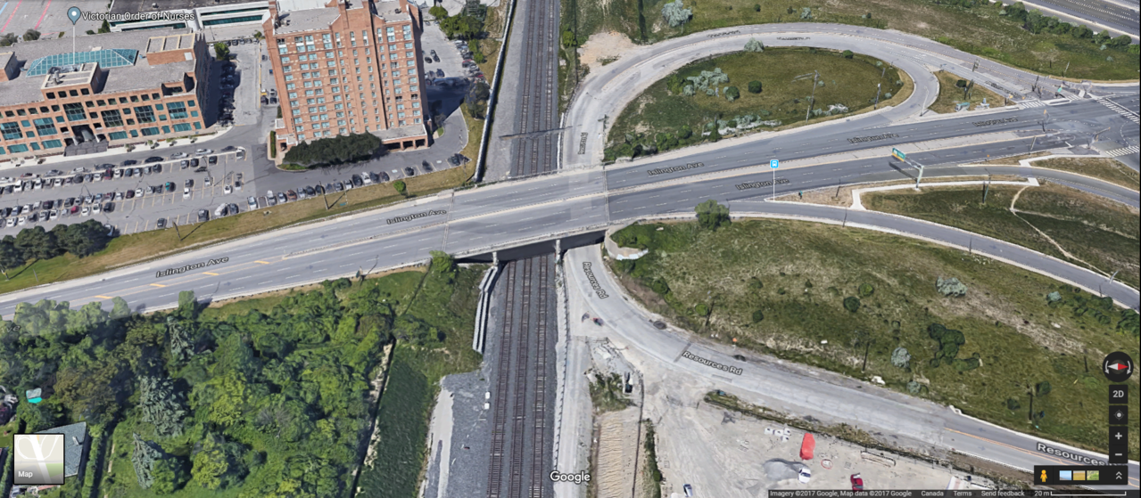

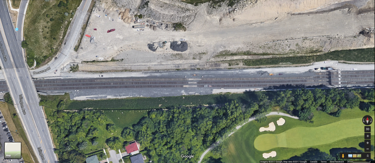

We have heard little about any plans to improve the GO station at Etobicoke North. Adding the fourth track will impact the access to the present (temporary) station. I wonder what’s up with it.
My understanding is that track shifting would occur to allow the new track to be placed on the south side of the corridor to eats of Islington, as the existing road overpass there would be able to accommodate it. Around there, tracks would be cut and shifted from how they're laid now. WRT Etobicoke North, there's space on the south side too where they removed to former platform, will just require a new structure over Kipling.
The fifth track for the tunnel, though? No idea. Maybe a lead to/from the future UPX maintenance facility that would extend to the existing northernmost freight spur west of the 401. But I don't know if it will fit under Islington without impacting Resources Road.
If the width of the south span is the same as the north over Resources Rd they just might be able to sneak two tracks through there by rebuilding the abutment to a purely vertical one, but they'd need to nip off some of the hotel and Toronto Hydro properties to do it. Hydro is probably getting nipped for the 401 tunnel work anyway, so that just leaves the hotel. (Note: Pure speculation based on Google satellite view.)
