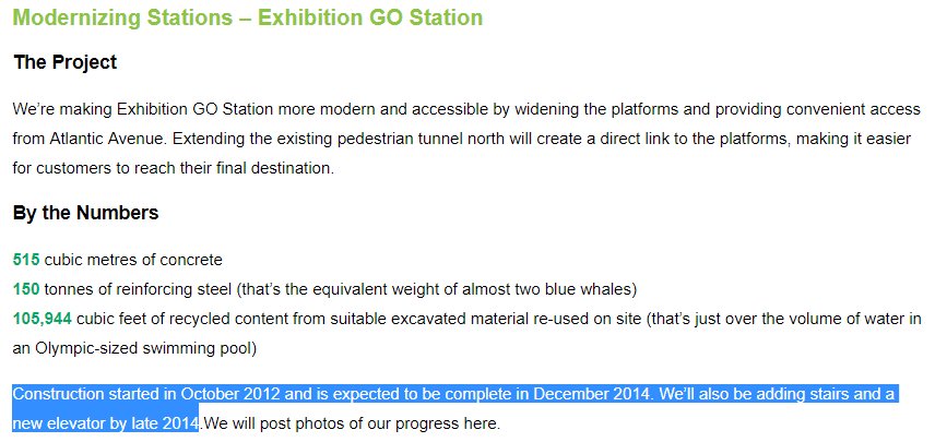

Great to see this announcement. I hope it included a couple hundred bucks for tearing down the plywood at the Exhibition tunnel ...
I hope so, considering that this month is it's 3 year anniversary of not being finished on time. And over 5 years now since it's started.
DQc-cxiVoAEL4lZ.jpg:large
I emailed Han Dong's office about it. We'll see what excuses they come up with.
Do plywood tear downs need an EA?
Last year I pushed my way thru the tunnel after MLS Cup Final i was beside 2 visitors from Seattle......they commented how horrible and “third world” the tunnel was....as we got to the north stairs to exit one said, roughly, “ah, that explains it, it’s under construction”.
Imagine what those same two would say if they are back for Saturday’s match and they see the tunnel in precisely the same state as last year!
They were certainly correct about the state of that tunnel, but I just have to take a bit of solace in that Seattle -- surely not just in my opinion -- has the single most unimpressive rapid transit of any large, progressive city I've ever visited. Not to mention shocking poverty on the downtown streets and a sorely-lacking nightlife. I somehow still like Seattle despite its shortfalls, but maybe shoot back with that if they're at the game tomorrow ;)
