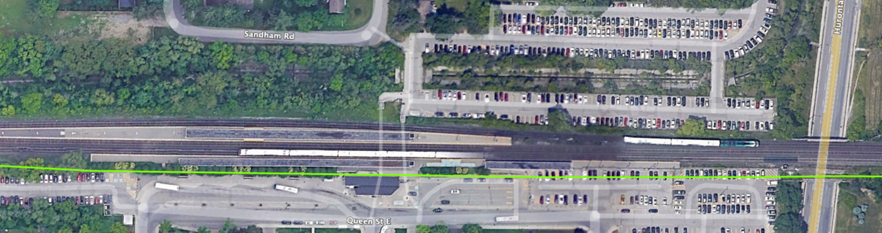

The green line for Port Credit station is the similar to the EA options when the 3rd line was plan from Port Credit to Burlington with the 3rd line going on the north side.
THere is a need for a 2nd tunnel today and needs to be part of the conversion of the side south platform to an island platform, Back for the 3rd track expansion, there was thinking of moving the south platform to go over Hurontario St and still can happen with some bridge widening.
