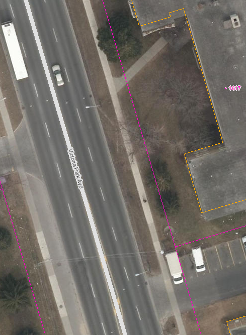

Take a look at this section of VP (roughly the same area) with property lines showing.
On the East side you'll notice you're going to have to pinch a parking spot; but also cut down all those trees if you want either place the path to the inside of the sidewalk or relocate the sidewalk to place the boulevard to the outside.
Not going to happen.
Further, you currently have poles both in the boulevard and in the interior space:
Notice on the west side, that you have street lights on hydro wires on the space you're eager to repurpose. At the minimum, these would have to be relocated at great cost, alternatively, they'd have to be buried (the wires); but the street lights would still have to be moved.
It simply isn't practical in this location.
