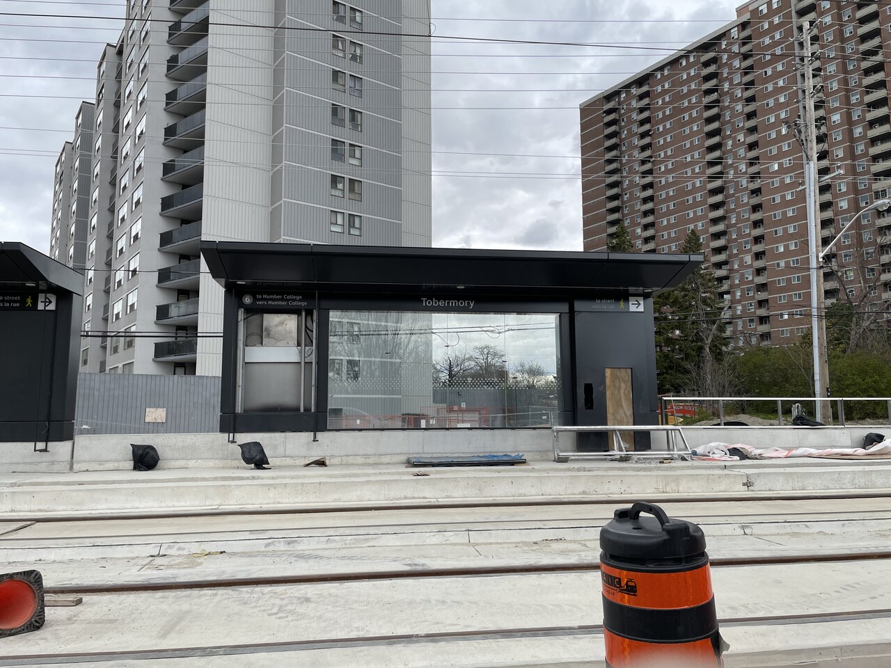

I yet to see how the rails are installed as there is only a grove in the concrete at this time.
One grove is wider to allow for the grove rail.
They lay the rail into the groove and then grout it in place. The idea is that there is enough fixational support with the special concrete used to prevent gauge issues.
Not groove rail. They are installing two pieces of T-rail side-by-side for flange guidance.
Dan
Thanks as it confirms what I expected when I first saw the grove concrete and where the rail was installed.
It looked then that the rail was held in place by special type of bonding material. Since I am only looked at the line on a rare case, don't get a closer looked at the line like I did for the Eglinton Line
As for double T rail, again this line is been built like no other line I have seen on my travels including the Hurontario Line. Hurontario is using Grove rail and I believe Crosstown has a few spots as well.
Here we have 3 LRT lines within 25 miles of each other and all of them are being built completely different with Eglinton being over built. Can't recalled what took place for the ION line, but I think Grove rail was used without digging through photos I shot for the line.

First off, it's Groove rail. There is no such thing as "grove" rail.
Using two pieces of T rail for the flangeways has been done in loads of places elsewhere, although not in Toronto before. It helps save money on specialized trackwork and minimizes using non-standard rail profiles. There seem to a be a couple of consulting firms that have picked up a number of the more recent LRT projects that seem to really enjoy using and spec'ing it.

ION used special profile guard rail on the inside of curves, which bolts to the inside of standard profile T rail.

As to the grouting I was seeing for the line, it looks like it's the Dutch Edilon Sedra embedded rail track system that is being used, This uses a Corkelast grout to hold the rails into slots in a concrete track bed (https://youtu.be/KOE5LpQDKRM)
