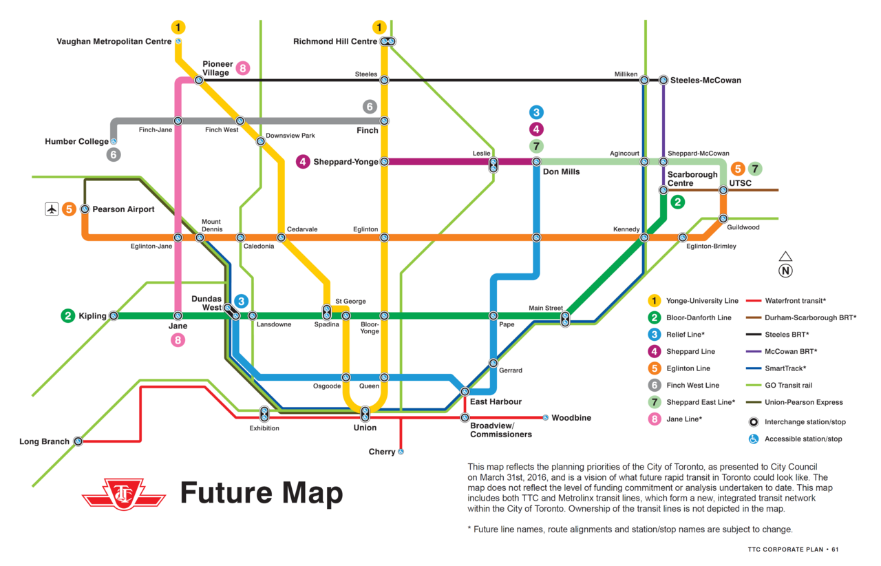

You haven't seen them before, neither have I, so "new" to UT. Let's try to not be so picky in the future, can we?
Actually, I was wondering if they'd changed the plan, and this was no longer going to be Line 6. I wonder how they compare to the previous renders someone posted - I think further up this thread.
