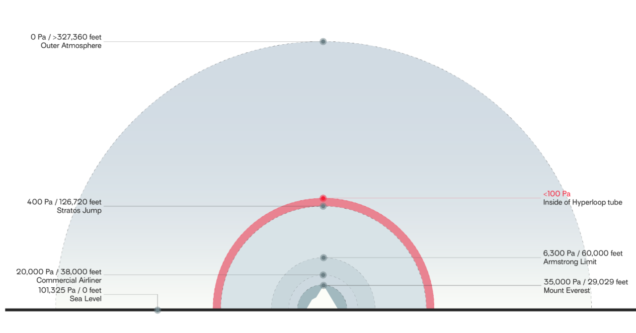

i don't think i'm being misleading using the same terminology that the proponents use and believe both they and i are using the word correctly. a vacuum is practically defined not as being devoid of all matter (which would therefore have zero atmospheric pressure, sometimes referred to as a perfect vacuum) but as any space having a gaseous pressure substantially less than atmospheric pressure. given atmospheric pressure (at sea level) is nominally greater than 100,000 pa and hyperloop proposes an operating environment of less than 100 pa, i'll stand by it. from hyperloop's own website:
whether less than 100 pa is possible to generate and maintain is key to all of the performance/speed algorithms being used to support their claims so i think it's more than fair to consider the implications of having to deal with that level of vacuum.
