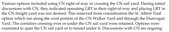

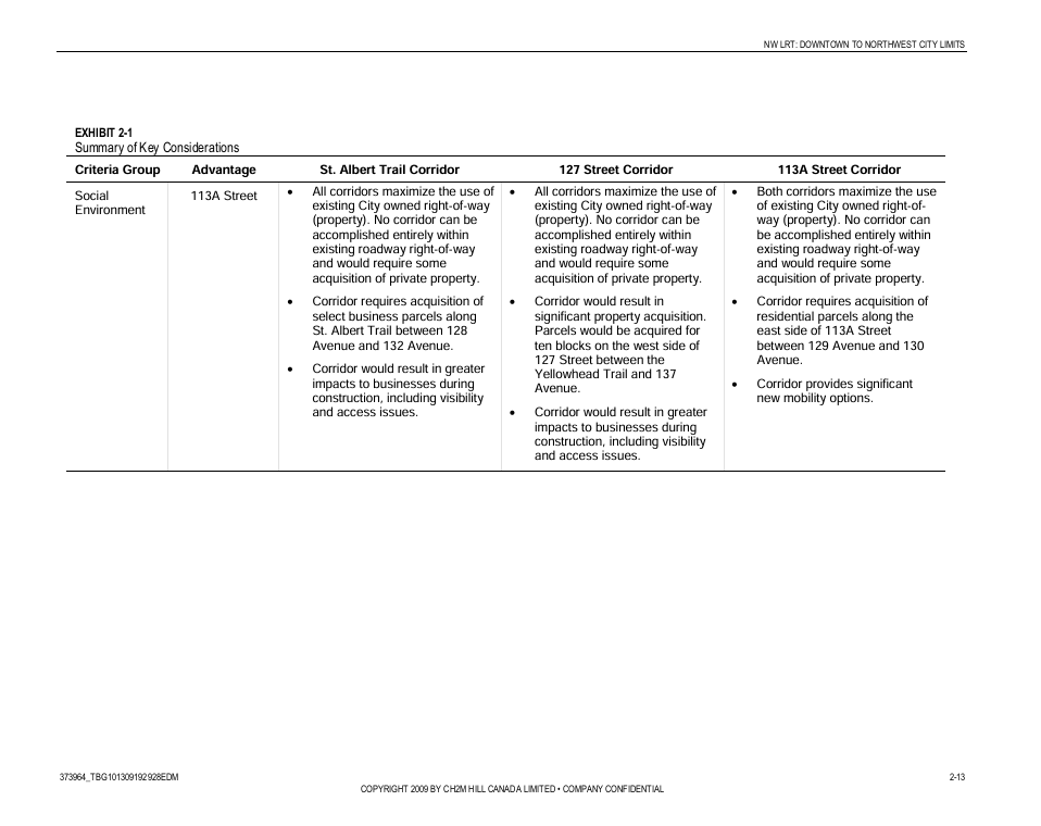

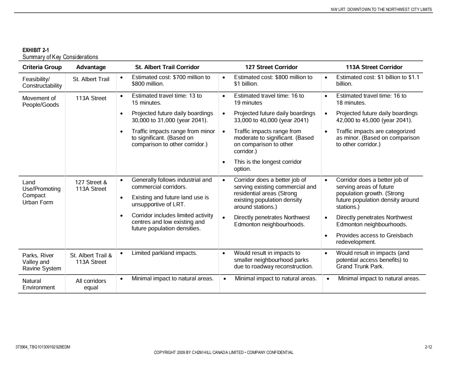

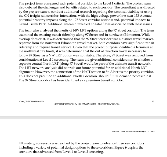

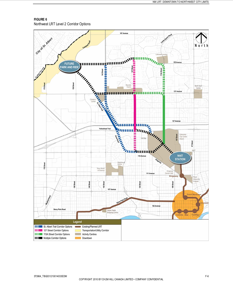

All corridor options were designed to integrate with Blatchford, but it did not constrain the options. The source is this report from this council package.
The dismissal of 97th Street as a potential corridor for the Metro Line is ridiculous. I can’t believe the city planners were so insistent on prioritizing the link between St. Albert to NAIT that they completely neglect the massive ridership potential on 97th Street (actually, it should make sense considering where a lot of these city managers might live).
For a 1.3 km “out-of-direction” travel distance along Yellowhead Trail:
- you could put the 132nd Ave station next to TWO high schools - whose students are more likely to take cross-city train trips - instead of an elementary school
- the 137th Ave station would be next to Northgate Mall, the transit centre, and the actual commercial and high-density residential centre of Griesbach instead of being surrounded by mostly single-family homes
- you could add a stop near the Eaux Claires transit centre (and relocate it)
- the trains wouldn’t have to go around that at-grade 90-degree turn pulling into Castle Downs
- the span across the rail yards would only be 80 meters
- so much of the bus network would feed into the LRT instead of needing a BRT to run parallel service a mile east of the LRT
