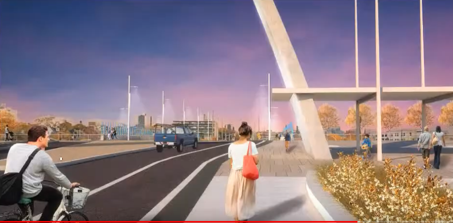

Assorted panel comments:
Panel was kind'ish, but generally were a bit underwhelmed; multiple members asked if the design/public realm could be more celebratory, a bit bolder, maybe some colour.
There were also a couple of comments on the narrowness of he sidewalk, which is pegged at 2.5m on both sides, the bike lanes 1.8m+ 0.8m buffer.
Also noted was the need for mitigation measures for 3 diff. crossing points of the LRT tracks by pedestrians/cyclists, and some question about whether the treatment of the 2 spans could be more harmonious. The glazing over the railway corridor was an Mx imposition.
My comments: Transportation should be directed to accept flowers and shrubs on bridges. I get not permitting trees..........the argument against flowers is that they can thrown off the bridge; but people who want to be jerks can bring their own material to throw.....
The sidewalk capacity seems low, I agree, on questioning from the panel, the City staff admitted they hadn't yet modeled to see how much pedestrian capacity was actually required....... (insert eyeroll here)
I'd be interested in thoughts from UT's cyclists, but it strikes me that a multi-use path on the east side might be preferable to bike lanes here, it would be a more efficient use of space, but would also eliminate two interactions with tracks at Dufferin Loop.
Final thought, night-time illumination of the bridge and the arch should be a design consideration.

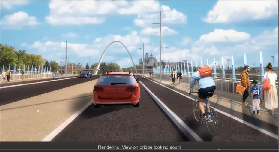

The one render appears to show a large median on the bridge separating car traffic. Am I correct? If so, this appears to be a width that could be more appropriately purposed for pedestrian and cyclists.
Reserved to future LRT tracks.
Ok.That makes sense. Now for the modelling of pedestrian and cycle traffic. This is an important connection (think of the masses flocking to the ‘spa’) and it would be a real shame to under build the bridge.
Agreed, I don't see why it can't be widened.
