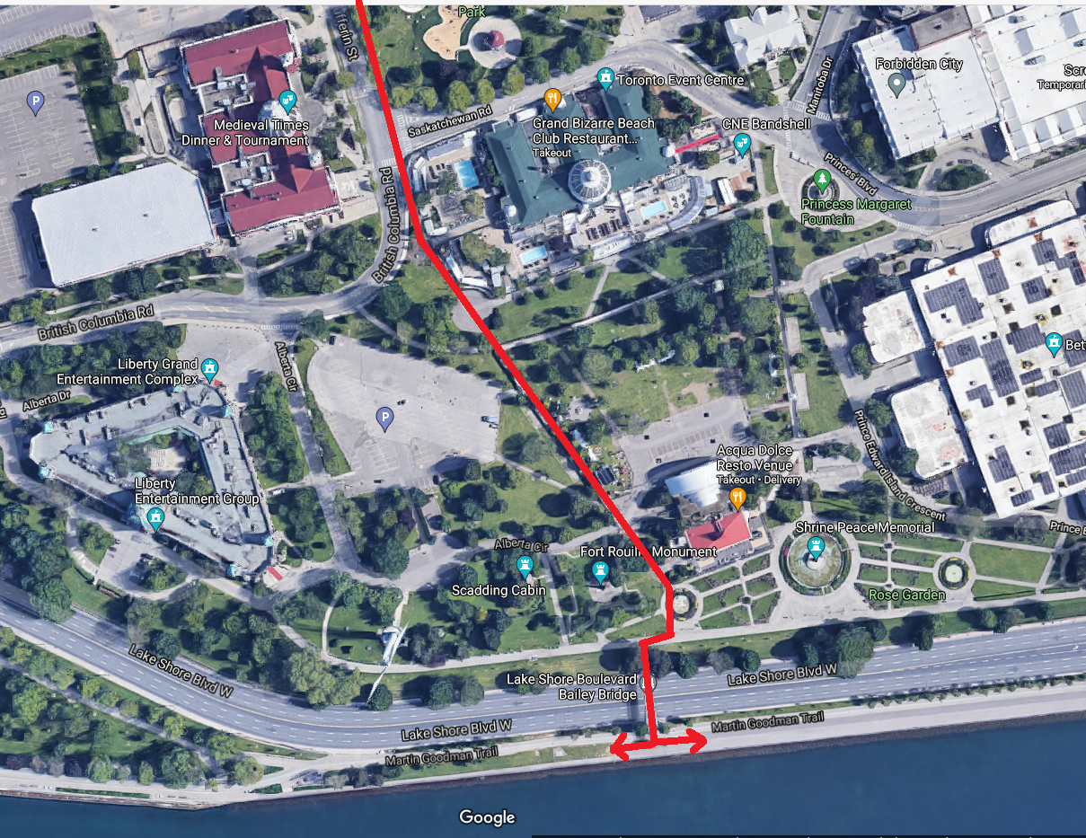

good thing about walking is that you don't need a road. There is already a quite pleasant walking path on that route:
Putting aside any pedestrian or cyclist challenges with the above option, and that it doesn't afford a transit connection.........
It does nothing to ameliorate Lakeshore Blvd itself.
Lakeshore is a veritable highway, its ugly, its unpleasant to walk or bike along in this stretch, and it serves to create a material disconnection between the Ex. grounds and Ontario Place.
Creating a new at-grade intersection at Lakeshore is one small step in the direction of humanizing it.
It also needs to be stripped of one lane in each direction, and benefit from substantially better streetscaping and pedestrian/cycling conditions.
