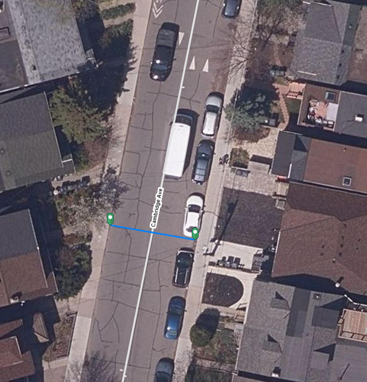

If it's made one way for cars surely it can fit a contra-flow bike lane, perhaps a contra-flow cycle track with some physical protection? It can have sharrows going the other way, and maybe some speed bumps to slow cars down?
All the precious parking can stay.
Here's what you have to work with:
That's 9.5m curb to curb, deduct 2.5M for the parking, you have 7M left.
A very minimal, sub-standard bike lanes is 1.5M (Toronto would generally require 1.8M)
Re: One-way. Nope.
If you look at the, very south limit of the street is one-way SB to Danforth, and for a variety of reasons, flipping to NB is not on.
IF you went all SB, you run into a variety of challenges, no left turn to Danforth makes it very problematic, further north you also have a major apartment building with parking.
I understand no cycling infrastructure will fit providing we keep the street two way for cars and keep all of the on street parking.
I guess I haven't put enough thought into the implications of making the street one way for cars.
