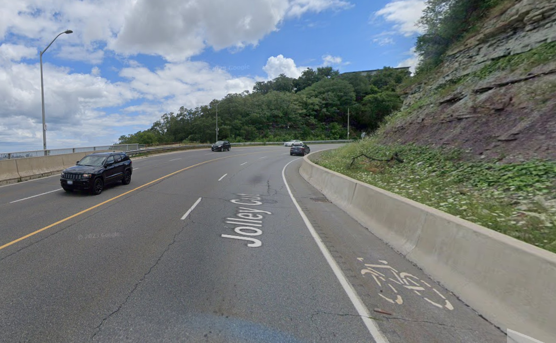

Deep Hamilton nerding: One scheme that I really wish the city would explore is to get rid of these useless suicidal lanes on the Jolly Cut: and to expand the multiuse path further down down the bridge to the Keddy Access Trail. It would only require 100m of changes to the bridge's sidewalk, which is currently an awful experience for pedestrians as you're inches away from 70 km/h traffic. The lanes are overbuilt and have a ton of room for modification. That small multiuse path would tie the last remaining gaps in the lower city and upper city together, allowing cyclists to bike from the downtown to the entire length of the urban escarpment without using any fast-moving arterials.
I agree, this:
Is not desirable.
There's a bit less room than you think, but it looks do-able to me:
On a curve, with those speeds, you need ~13M for the travel lanes, some would argue for a fraction more, particularly near the turns.
That leaves you ~3M for the MUP, which is just wide enough, but with no barrier. A barrier requires ~0.8M give or take.
Looking at where the existing barrier is on the upbound side, I think it can be squeezed in w/o any enormous engineering or expense. They might require the barrier to be higher on the upbound side with less room to potential falling rock.

Re: road width at the cut - what I'm actually suggesting is to completely remove the road infrastructure from that turn. It's dangerous and we shouldn't encourage cyclists to use it at all, if anything it opens the city up to liability with how irresponsibly it's built. City buses routinely intrude into the lanes making the blind turn and eventually it will result in a massive lawsuit. Instead, the multiuse path at 12 o'clock in this image should be the preferred route pushed by the city and signage. In fact, the city just repaved that trail in December as part of a multi-million dollar plan to develop Sam Lawrence Park (think Mont Royal Park tourist trap) and the two short stair sections have built-in bike gutters to get bikes up and down easily!

This is what I was looking at:
Is that what you had in mind?
The measurements I gave presume the removal of the existing bike lane.
That's it exactly- I think the key issue is whether the city can actually modify anything (ex sidewalk removal and conversion into wide path to match the upper section) on that roughly 100m of bridge deck for a reasonable price or without cutting off the second-busiest access for months of repaving. The city also wants to put a multiuse path all along Concession from the bottom left of your image to past where the trail you've highlighted intersects it, so it just seems like such a no-brainer if it can be done for a reasonable price.
The city also wants to turn that area you've highlighted into an important Bruce trailhead with infographics and maps :) It's funny, I've done most of the Pacific Crest Trail and Arizona Trail, but despite living and working a few meters away from the Bruce, I've only done a few km of it!
