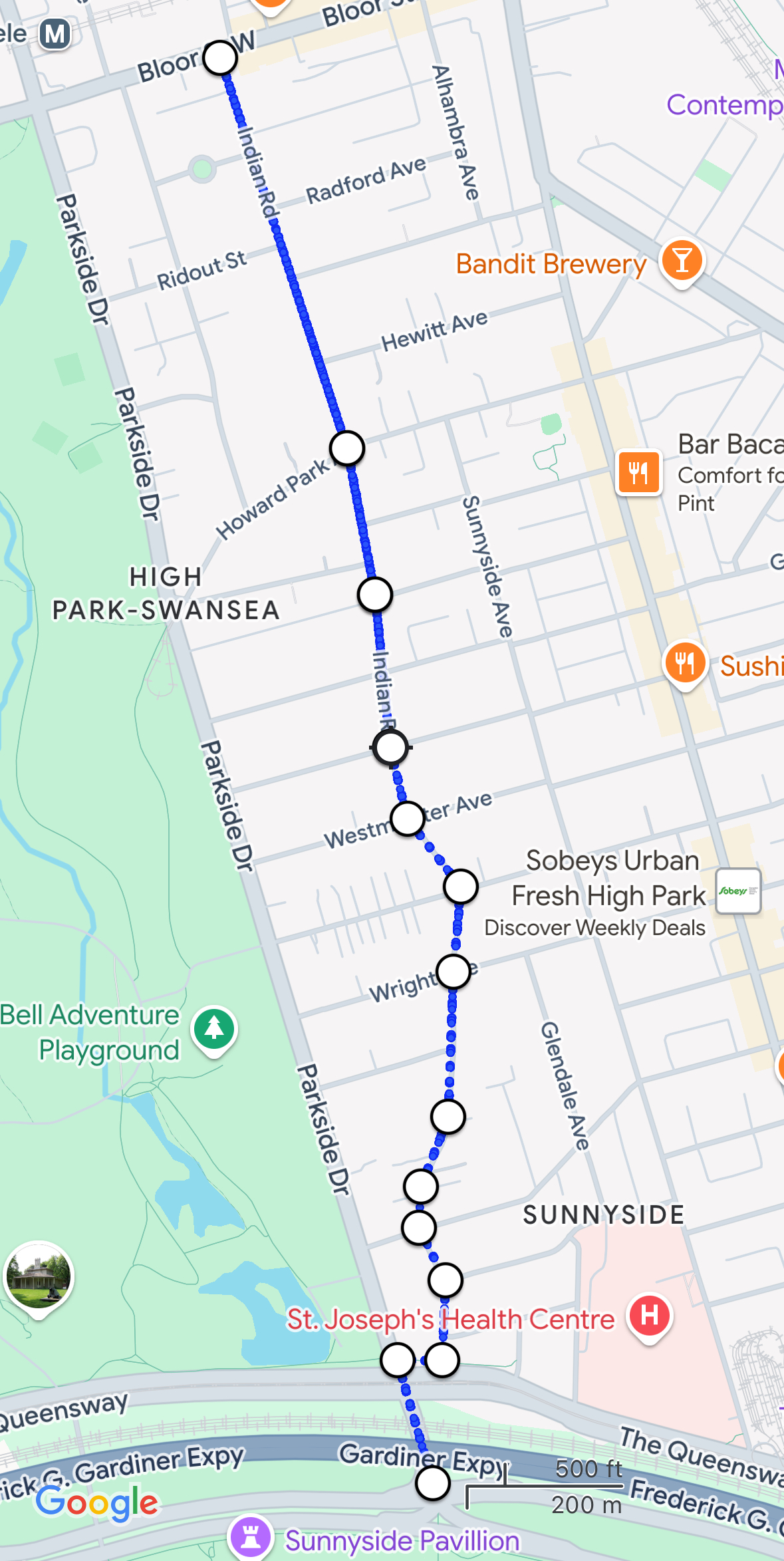

Here’s a Parkside alternative I’d like to see explored:
  • Reduce Indian Rd. to one-way with contraflow cycling. Opposing auto travel is supported by local roads Indian Grove and Sunnyside
  • Expand the pathway connecting Claude, south end of Indian, and Parkside
  • Under the bridges on Parkside, remove one northbound lane and replace with a two way cycle track. This lane is really just for overflow now since beyond the underpass it is used for parking. Two lanes southbound is reasonable as there are two choices of direction at the Lakeshore intersection
I may be out of the loop, has anyone proposed this previously?
