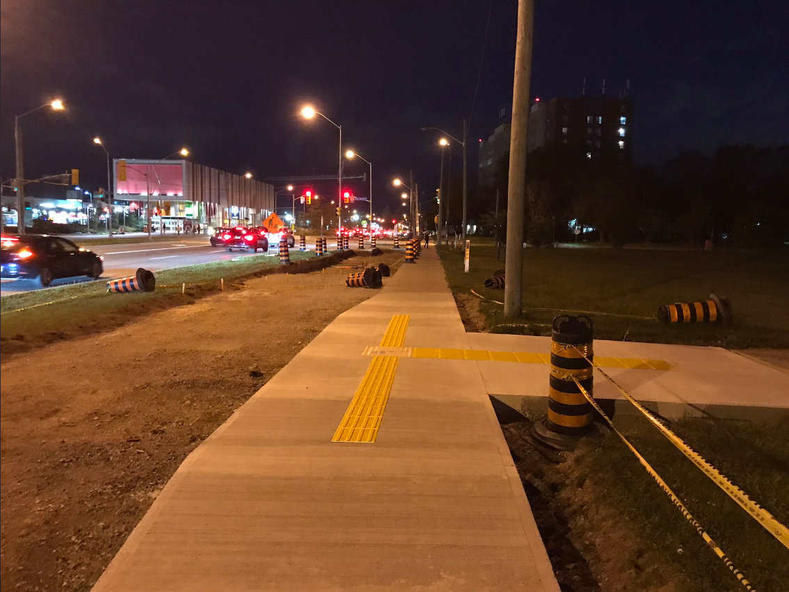

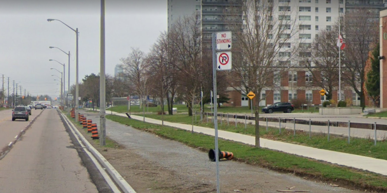

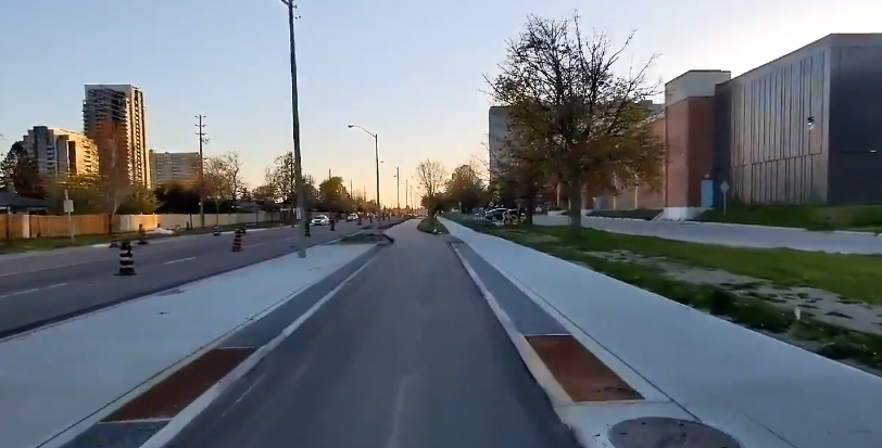

For reference (sorry for the low quality):
This recently installed trail on Ellesmere west of Golf Club Road (supposedly the highest standard,) is a stub trail that extends the current meadoway trail by about 700 metres. It's actually high-quality, nice width, green markings, bike signal and even an island bus stop. It unfortunately abruptly ends at a random driveway east of Markham Road and then cyclists are riding on the sidewalk again.
What good is a fancy new trail if it ends before it needs to, and what good is a trail if I have to illegally ride on the sidewalk 90% of the way there.
This is the main problem. City staff take pride in high-quality but stubby infrastructure. And it shows, just look at the plans. A few stubs scattered and a few major routes that have been in the plans for decades like Kingston, Sheppard, Victoria Park and Brimley that still need additional planning apparently.
Agreed.
I don't think 'take pride' is the right expression.
There are serious obstacles to getting approvals for the version of works you (or I ) would like to see.
Half measures often get built, because there is a 'better than nothing' attitude; that is to say, the cycling unit has money to do something, they want to do something, but Transportation as a whole, or another unit, or the Councillor won't
allow the road narrowing, or bus-layby removal that would be required to take a trail or bike lane to its logical destination.
The unit then decides to build what they can, rather than nothing.
Its not the way it should work; and I will make no excuses for those that hold up the proper versions of projects. But it is a reality.
