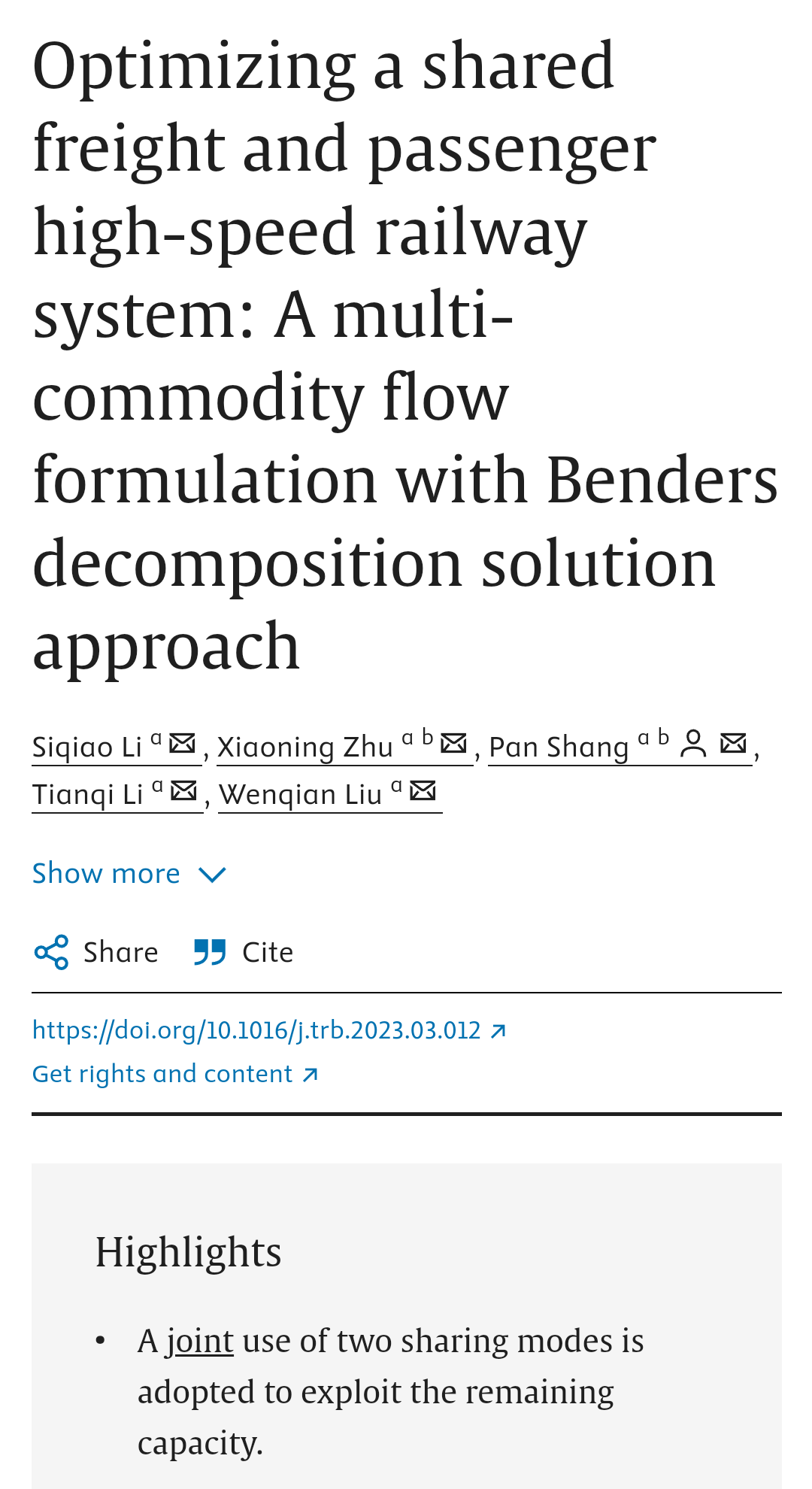

Per the above, the fastest mixed use track in the US has a top speed of 145kph, which is ok-ish.
I suppose the provinces report will say whether its cheaper to upgrade CN or run new rails for passenger service.
It'd be nice to see 200kph min for the regional lines, and 400kph for the Calgary link, much like the Cascade project in the US.

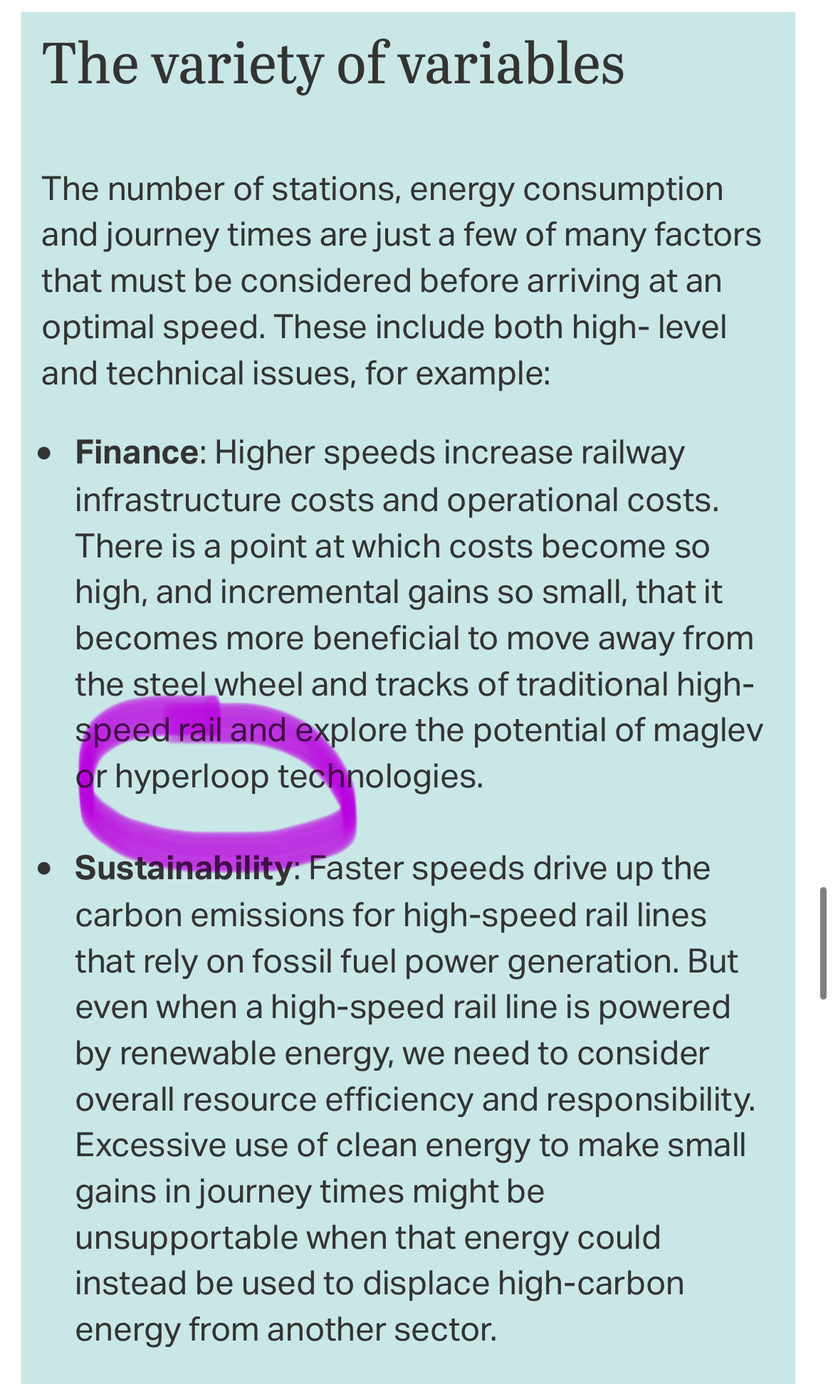

There is at least an upside to being able to use the same ROW (ie less land acquisition), but those 145km/h limits are in a few very wide-open places with easy grades and very straight track, and the CN line rather does wiggle its way up to the Rockies on account of topography. 400 km/h isn't anything we'll see for Calgary. Pushing above 300 is very rapidly diminishing returns territory.
Well I couldn't find any info on what train they are planning to use on the Cascade routes, I did find this report which confirms what you said about diminishing returns.
It does seem like 300 kph is the overall sweet spot, and that could still be fast enough to do the DT to DT trip in not much more than an hour, which should be the service goal for the line IMO.
