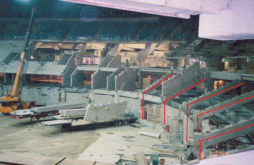

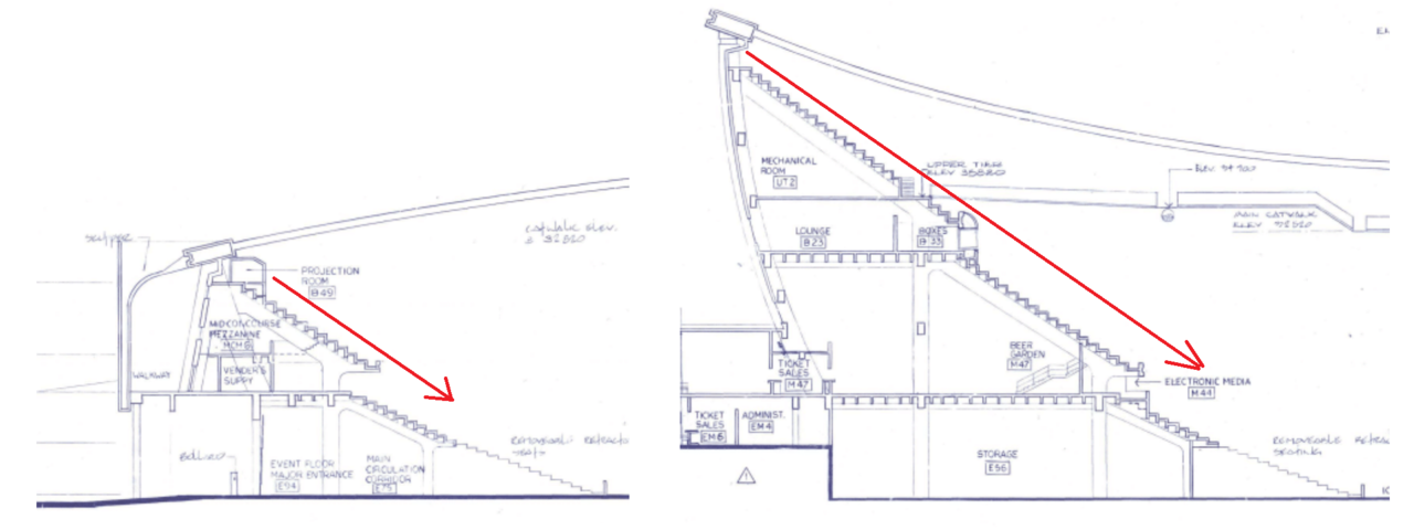

Anything that teases out what might be structural versus things that can be removed would be neat. I doubt without an engineering degree could conclude much more than casual observations for construction photos, but if you see one that stands out (a cross section? mind throwing a screenshot up here?
Also, depending on the provenance, the University might appreciate a copy for the architecture archives.
It's 128 pages. Found a way to share by link.
https://www.dropbox.com/s/wqw7a1l6z5b1he7/BP1981-F2991 - Architectural Plans - Roll 1 .pdf?dl=0
Elevations on pg 67/68. Sections start at pg 69.

So, undoing my previous speculation and enthusiasm, I bet a significant tension load from the roof is supported from the stand supports - almost like flying buttresses but internal. With enough load removal, is the lower bowl buttress needed? My gut says yes (the lower bowl butresses exist for a reason), but a study might say no with a reduction of load.
I guess the question for reuse: how much more is the blue circle (concourse butresses) worth to convention business versus the green circle (lower bowl buttresses).
Could always do this instead: a floor at concourse level, and a daylighting of the concourse, leaving the buttresses and removing the prefab seating sections, but you loose a lot of flexibility (and the potential for lowest possible cost) and the appeal of a high column free surface with the ability to truck things in:
