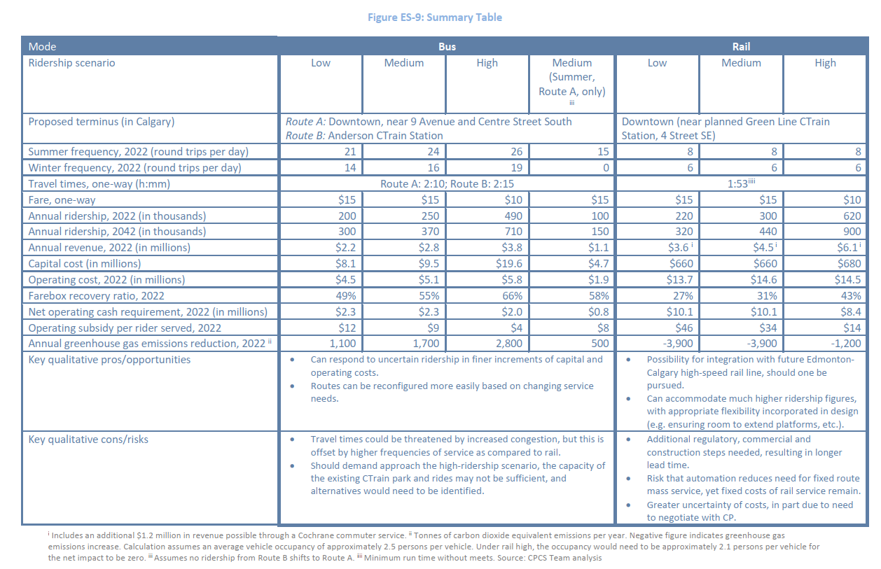

The thing about more studies is maybe they will produce different results from the last study. Here's the summary table for the 2019 Rail to Banff study:
Comparing the medium case for bus and rail, the bus alternative provides:
  • 84% of the ridership
  • 1% of the capital cost
  • 22% of the operating subsidy cost
  • reduced greenhouse gas emissions, rather than substantially increased emissions
It's a pretty obvious home run, and could be implemented basically immediately. For $9M in capital cost; we're now devoting 1/3 of that to one study on one hypothetical part of a rail system.
Is the government not interested in prudent spending of the public dollar? They sure talked about that a lot a couple of months ago.
Are the supporters of mass transit to Banff interested in increasing or reducing GHG emissions? (We'd have to implement the buses twice just to offset the impact of implementing the rail once!)
The possible explanations are not very flattering.

Those ridership stats are bullshit. Taking a train is superior and much easier to explain to tourists. Buses fucking suck, no one likes buses.
I stand by my statement; the possible explanations for choosing the option that costs a hundred times more and gives worse results are not very flattering. The strongest arguments are "trains are cool", which I'd be pretty fine with if an 8 year old were planning a transportation system, and "Buses fucking suck", which sounds like his older brother angry he can't borrow the car.
