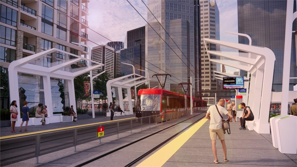

We get one look at the bridge over the pathway in Eau Claire from this tweet yesterday:
I'd like them to take a good look at examples around the world on how to activate the space under the bridge. Even something as simple as some swings that are mounted to the bottom of the bridge can make a huge difference in the feel of the space.

Looking at the overview schematics I like the center street surface alignment - until it gets to 16th ave where it needs to be grade separated. The bridges and interaction with the island and pathway are just ok (really what other option is there at this point). However looking at the schematic of the 2nd st station & alignment over princess island it looks like those condos with green roofs will need to go and a big chunk of eau claire (so long garage). They are planning on cutting off 3rd ave from 2nd st and creating a one way north on 2nd too, I used to work with a view of that intersection and everyday during rush hour it is very busy with commuters using that connection to get the lower level bridge. I think you'd have some serious gridlock there.
I know the Eau Market redevelopment is a ways away yet, but I hope they design the Eau Claire station with the option of having it attached to the new development somehow. It's hard to tell from the renderings, but it appears there is no auto traffic on the west side of the station which should make integration easy enough.

I didn’t look hard enough..., I see there is a station planned for Eau Claire
Isn't this literally where Eau Claire market is right now on the right? Are they knocking it down for the green line? There's also a bunch of Parkade entrances on 2 St for those condos, wondering how that works in this configuration.

- Yes there will be a station at Eau Claire. The city is in discussion with Harvard about using the eastern portion of the Eau Claire market land for a portion of the Eau Claire station. This would be tied in with the redesign of Harvard's plans for Eau Claire and the demolition of the existing Eau Claire market building.
