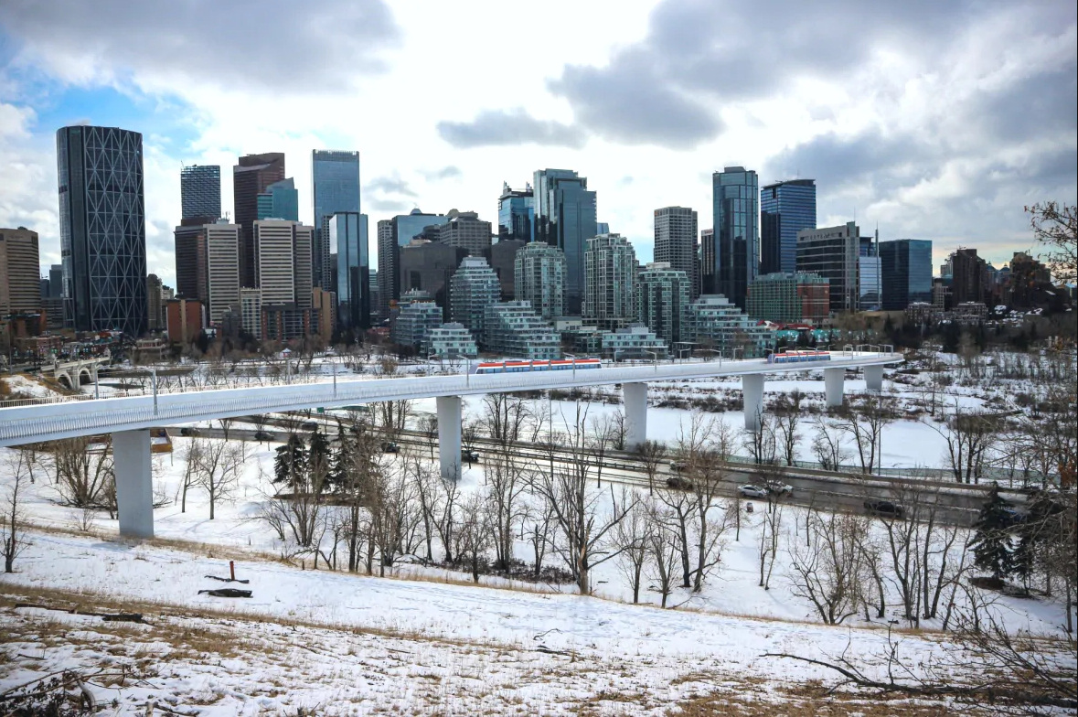

Hate them all, especially the suspension bridge concept, if that in-particular gets built it will ruin the views from the Bluff. If I'm being forced to pick one I feel that the trestle will be the most visually appealing.
Interesting perspective. I hate the trestle and plain bridges the most, and I like the suspension bridge the most. A nice modern signature could could be a good juxtaposition between that and the Centre street bridge. Thank god city bylaw is that no new pylons can be punched into the river, so the plain options likely won't be accepted. Though some improvements could be made to the trestle design to make it both somewhat aesthetically appealing and make it across the river in one span.
Tied arch could be nice, except for whatever the hell that is :oops:
I'm not honestly a fan of any of them either though.
Edit to reply to above^ The trestle is the nicest looking imo.
Few questions,
Can someone tell me why the hell the middle of the tied arch is orange?
Is the Centre street north stretch at-grade or below grade?
and finally, is there renders of how the bridge will be built through the area of the river walk? That is the part of the bridge I'm mainly concerned with.
