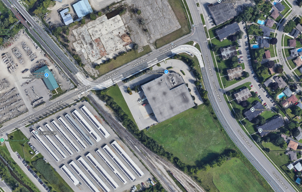

I was in Kitchener for work about a month ago and since I'm a transit nerd, I rode their LRT system just for shits and giggles. It was kind of a neat system, but low-floor trains are weird.
Bad:
1. The floor is uneven. There are weird slopes in the floor, but there weren't any steps.
2. The LRT cars were a lot narrower than our LRTs.
3. The seating was odd too. Some seats were large and raised up. It gave the feel of a bus more than a metro style train.
4. There were some sections where the tracks made a 90 degree turn and the train slowed to a crawl. I cringed on this section of track. The train slowed to a crawl and then stopped for the traffic lights.
Good:
1. The system appeared well used and well connected to downtown and the Universities.
2. Travel speed didn't seem very fast. But it also didn't seem slow either. Maybe this was just due to the tri-cities being geographically smaller.
3. The stations seemed simple, easily identifiable and well integrated into the street.
